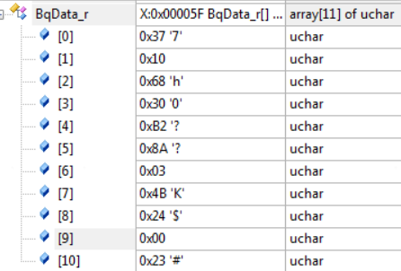

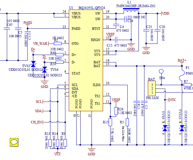

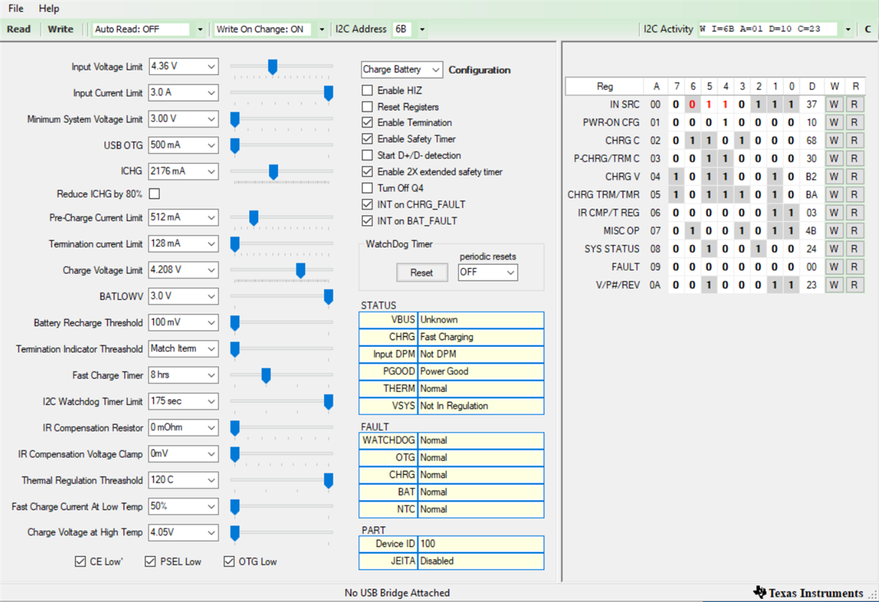

My customer met problem of BQ24195L, the charging current is limited to 100mA. input is 5V3A adapter, the registers read back is as below, I can't see any problem.  also schematic is as attached, please kindly suggest what may go wrong. thanks.
registers list:
00   37
01   10
02   68
03   30
04   B2
05   BA
06   03
07   4B
08   24
09   00
0A   23
