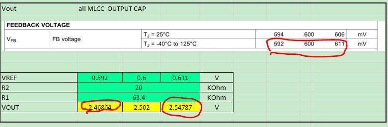

TPS568230: Vref variation vs Tj
Part Number: TPS568230
Other Parts Discussed in Thread: TPS54821, TPS54824, TPS54302, TPS51362, TPS565201
Hi Expert,
If we consider the Vref tolerance , the Vout Range is too wide, ΔV=79mv;
May I know the detail trend of Vref change VS Tj?
Or if there is an alternative solution whose Size is not bigger than TPS568230 and the DC accuracy is more narrow.
