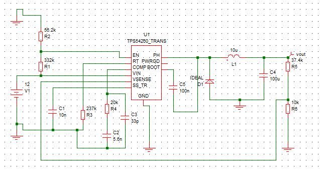

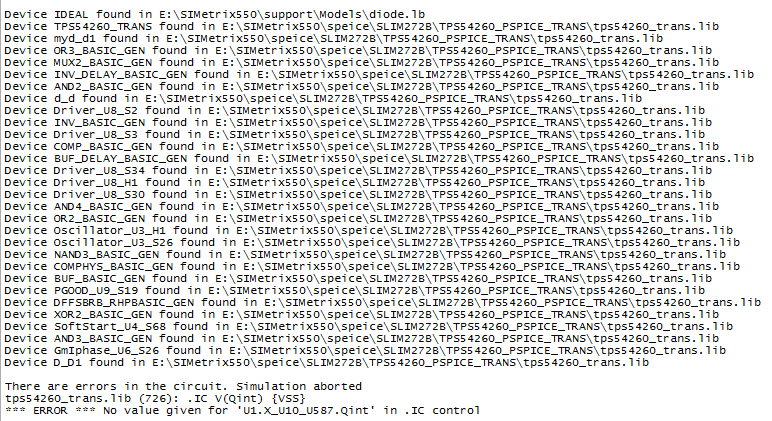

Please see the picture as below. Download the simulation model of TPS54260. No sumulation have been run by Simetrix/Simplis. The command shell as below.Would you help tell me why ? what wrong is it

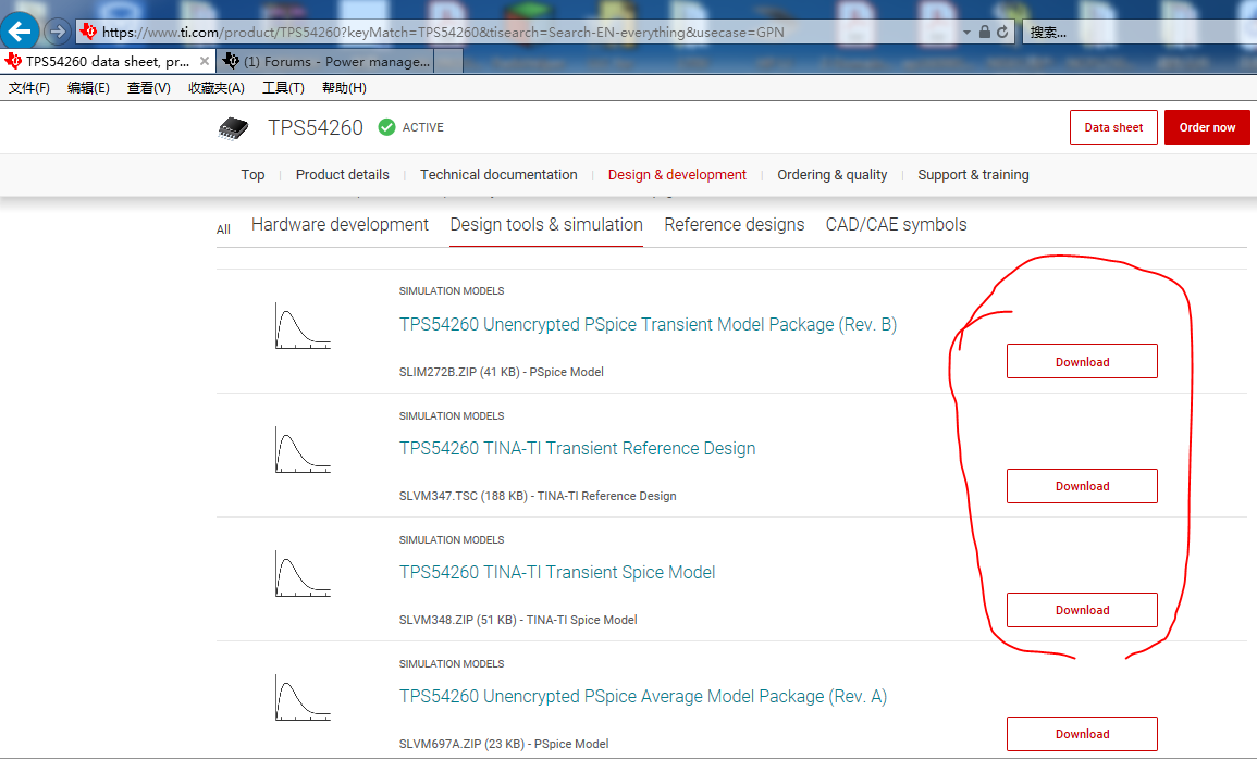

Thanks for you help.The link as:
https://www.ti.com/product/TPS54260?keyMatch=TPS54260&tisearch=Search-EN-everything&usecase=GPN
Section Design & development, find out design tools&simulation.
I think I am a little confused here. Models that you pointed here are TINA and PSpice models, but the image that you attached seems a Simplis Model simulation.
Dear Ankit Gupta,
I am not sure the TINA or PSPICE MODEL of TI TPS54260 can be used by softwave Simetrix. In normal, Software of Simetrix can add PSPICE Libraries. Here, successfully add them . But found out can't running by SIMETRIX Simulator. So ask help form you. If the TPS54260 can't support by softwave SIMETRIX. I want to know where have the model which can be used by simetrix? Thanks!

If choose the simplis simulator in SIMetrix 550, Can't find the model of TPS54260. Just can find then on SIMETRIX Simulator
Kindly share the test setup(SiMetrix file) to look into this reported issue.
