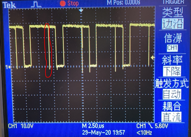

When input is 7V, output is 12V, load is 51ohm, every thing work good, but when change the Rfbt=180kohm, then output change to -21V, and use the same 51ohm load, DC output is right, but SW wave shows issue as below:

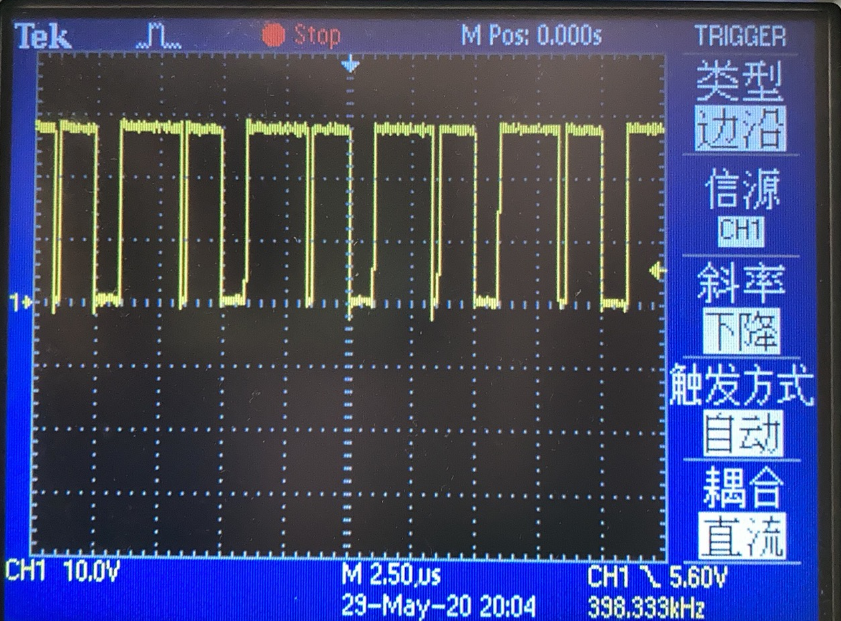

if change the load to 100ohm, issue seems become more terrible:
could you help to share some comments on why this happened and how to fix the issue?
Thanks very much,
Regards, Sunny

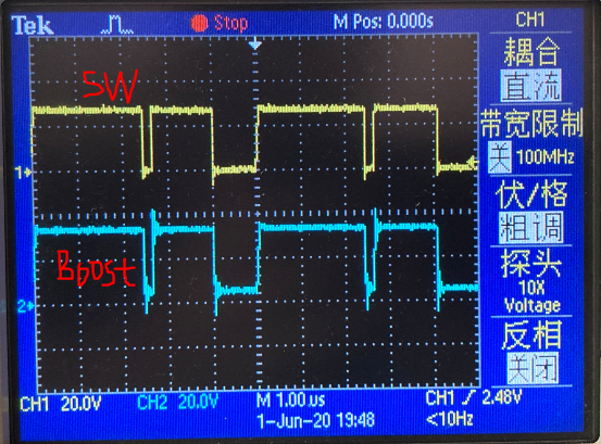

    Thanks for your comments, when I changed the boost capacitor to 334/50V(input 7V, output -21V, load 100ohm), issue keep same, below is the scope wave:
    do you have any other comments?
    Thanks very much.
    Regards, Sunny

    It looks the inductor is not large enough referring to Equation 5 in its datasheet, please change to a 15uH at least or 22uH inductor. Also could you please upload the PCB layout? If the feedback resistors are not close to device, there will be some noise coupling making loop unstable. Thanks.
  • Hi Iven,
    Many thanks for your comments, when changed the inductor to 47uH(as no 22uH on hand), SW issue disappeared. Thanks again.
