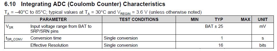

Hello support team,
My customer is investigating bq27426. bq27426 recommend 10mOhm shunt resister and the Coulomb Counter input range is +/-25mV, this means that the monitoring load range is +/-2.5A. However, they would like to use higher load current range, like 5A. In this case, they should use R= 25mV / Imax, is their understanding correct?
