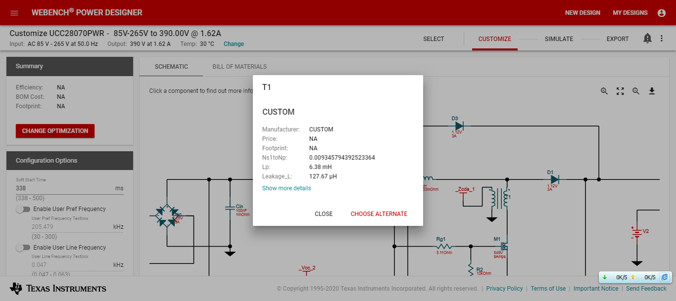

As above, I cannot put down such a large size in my product. So, can I replace the sensing transformer with a power resistor. If so, will the work of UCC28070 be affected?Thank you very much!
Hello user4657807,
The Webench model for the UCC28070 has nuances associated with the selection of magnetic components that affect the accuracy of the design.
It is recommended that you use the Excel calculator tool for designs with higher power requirements.
The Excel calculator SLUC114A is located here:
John
