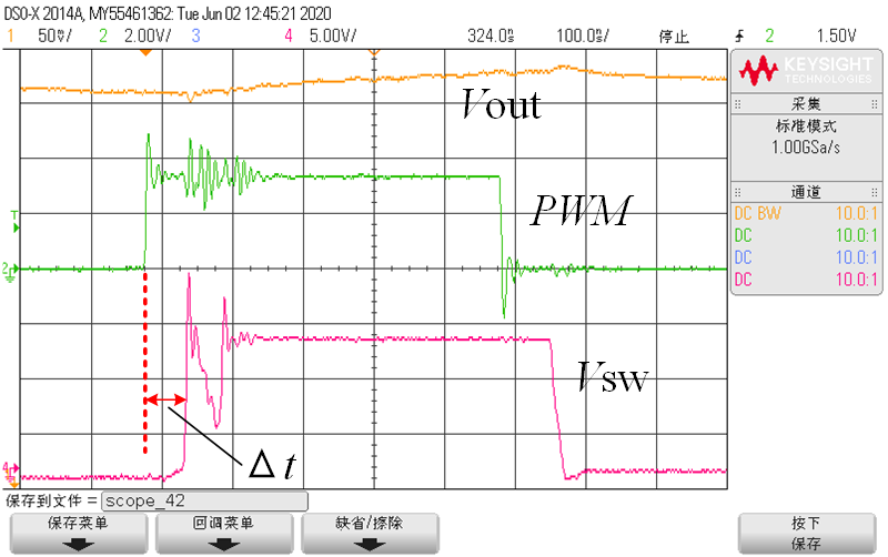

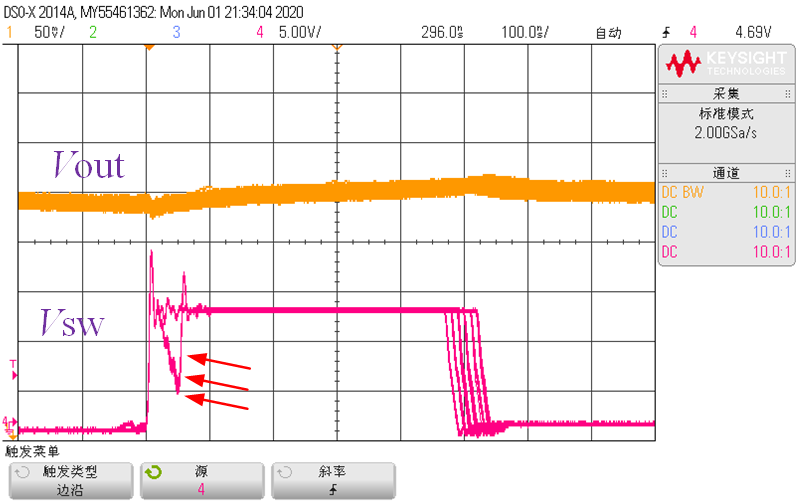

CSD95490Q5MC: There is a undershoot on Vsw( with Buck converter), when i used CSD95490Q5MC.
Part Number: CSD95490Q5MC

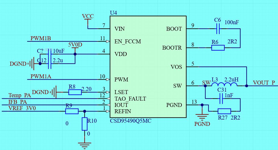

The Waveform and Schematic are as follows.

  • hello Qian,
    Thanks for your reply.

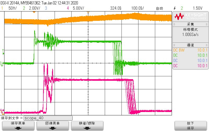

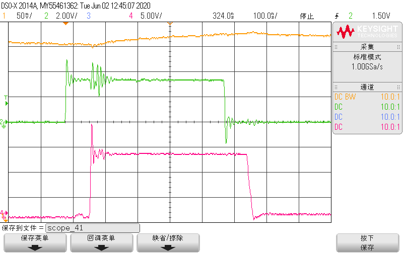

    This is the PWM waveform, The ‘undershoot of Vsw’ appears at an unspecified period(see first figure), and it's good at some period(see second figure).
    Today, I find that ‘undershoot of Vsw’ appears at the period with a short Δt(pointed out in the first picture), and third figure shows a dynamic waveform.
    And, Vin=12V, L=2.2uH, Cout = 100uF, Iout = 3A. Vout = 1.5V.
    Thanks.
    Tao
  • Hi Tao,
    I have below comments for your schematic:
    1. We suggest to choose Lout upto 1uH, and then need to select Lset according to the output inductance value.  You can find the chart of Lset value in figure 17 from the datasheet. For example, you need Lset=1.75Mohm (close to this value) if Lout=1uH.
    2. The 0ohm resistor from REFIN to GND should be removed.
    3. We suggest to place 2*22uf/16V/0805 +1*1uf/25V/0402 caps between Vin and PGND close to power stage, 1uf cap should be as close as possible to power stage VIN/PGND pins on the same side of PCB as power stage.
    Please try above mentioned modification, then see if the problem goes away. If you still have issue, you may want to measure:
    1. PWM1B to see if any noise coupling.
    2. High side FET Vds, to check if the FET was turned off due to noise coupling;
    3. Improve noise on both PWM1A and PWM1B if due to noise coupling;
    4. In the meantime, you may also monitor inductance current and Iout/REFIN with differential probe to see if current signals are normal.

  • Hi, Qingquan,
    First, Thanks for your reply.
    I find that EPWM1B is not right, it should be HIGH when normal. I put a pull-up resistance on this pin, then it work well without undershoot on Vsw.
