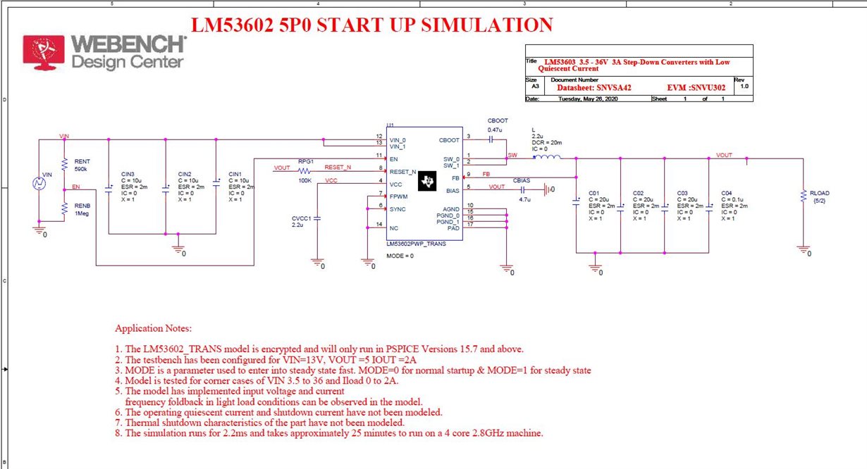

Can RESET_N pin of the PSpice model work in start-up transient simulation?
My customer simulated it, but RESET_N kept still low after Treset-act.
Best Regards, Taki

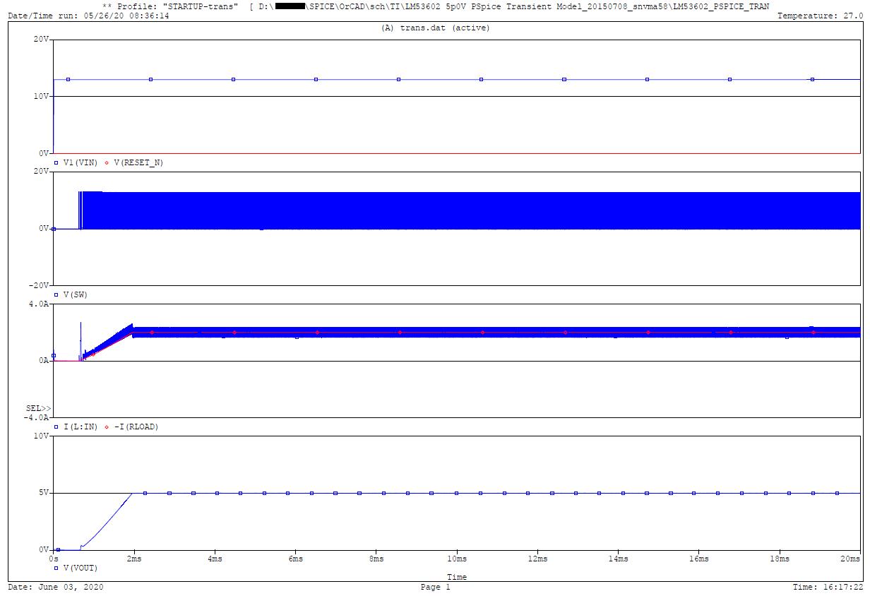

Hi, Sam-san
The customer Customer used SNVMA58.ZIP, but not SNVMA59.ZIP.
LM53602 5p0V PSpice Transient Model
The schematic which the customer used and the waveform as the simulation result is attached. PLS see them.
Best Regards, Taki
I run the simulation for the following PSpice Models, but RESET_N didn't work.
LM53602 3P3V PSpice Transient Model (SNVMA57.ZIP)
LM53602 5P0V PSpice Transient Model (SNVMA58.ZIP)
The signal works well in the following model.
LM53602 Adjustable PSpice Transient Model (SNVMA59.ZIP)
The customer want to simulate with SNVMA58.ZIP to use LM536025 for 5V output.
Could you check the both of model, SNVMA57.ZIP and SNVMA58.ZIP?
Best Regards, Taki

Taki,
I've submitted this question to the Spice modeling team and I am waiting for a reply. Sorry for the delay.
-Sam
Taki,
Sorry for the long delay. The spice team has identified the issue and will have a fix by the end of the month. Thank you for your patience.
-Sam
Sam,
It's great!
I will inform it to the customer. I believe they are satisfied.
