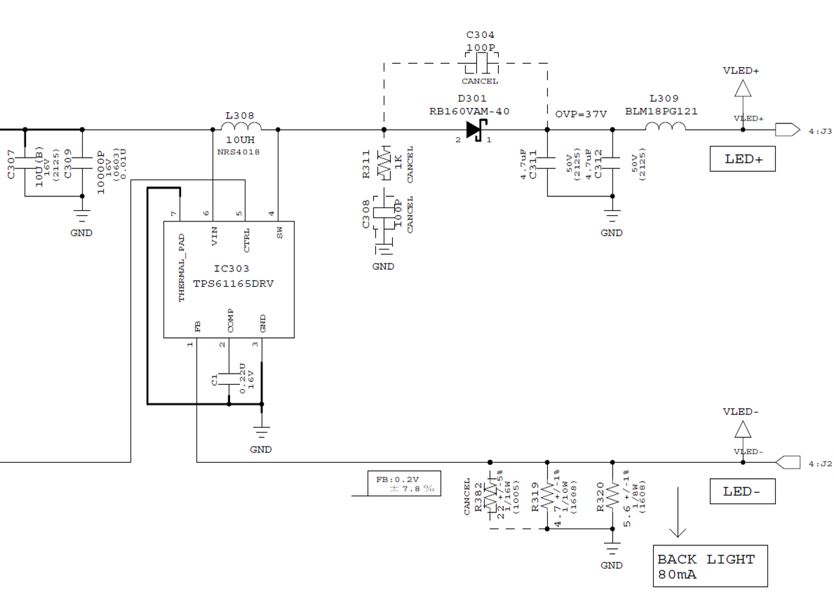

Dear all,
A sound sounds when I let this device work.
This sound goes down when customer add 1uF to COMP. (L=10uH)
May I add a capacitor to COMP?
Or is there the method good elsewhere?

There was not an effect by the removal of L309.
But the sound sounded small when customer changed to 4.7uH.
An effect improved more when I change a capacitor of COMP 0.33uF.
They think about error, so use to adjust by 0.47uF.
