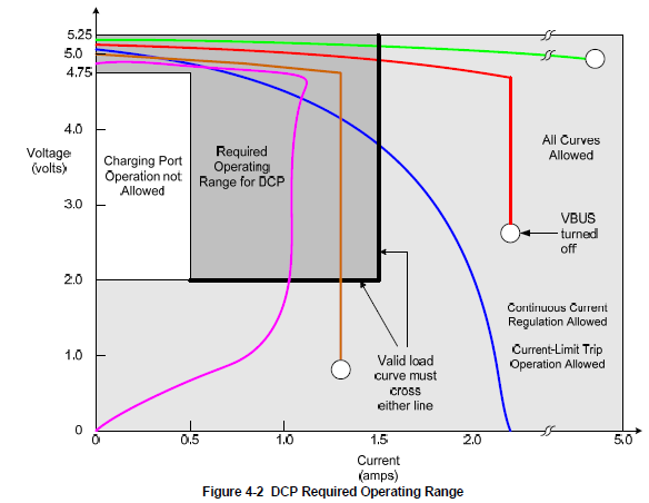

My customer is evaluating bq25890/2 and I got following questions so could you help?
Question 1
are there any way to disable "USB BC1.2 Detection → Ajustable High Voltage Adapter Handshake" flow by Hardware?
Question 2
could you share HVDCP_EN detail?
Table 11. REG02 shows HVDCP_EN.
DCP voltage range is 5.25V from below USB DCP specification so we want to know the detail about this HVDCP handshake.
- is there any explanation in DCP specification?
- what voltage is HVDCP?
- when/what event is this handshake enabled?
someting like that...

  • Kai,
    1. It can't be disabled by hardware, but it will not be triggered if HVDCP handshake is not initiated.
    2. To achieve fast charging, high voltage (9V/12V) adapter with USB compatibility (5V) is required. TI refers such adapters as HVDCP (High Voltage Dedicated Charging Port) in general including MaxCharge™. Several companies also have proprietary handshakes to achieve this goal. The HVDCP handshake connects combinations of voltage source(s) and/or current sink on D+/D- to signal input source to raise output voltage from 5 V to 9 V / 12 V.
    Similar to BQ25890, BQ25890H in addition provides independent controlled voltage output drivers on D+ and D- pins to interface or emulate non-standard adapters when input source is plugged-in or OTG mode is enabled. Please refer to http://www.ti.com/tool/TIDA-03029 for BQ25890H reference design.
