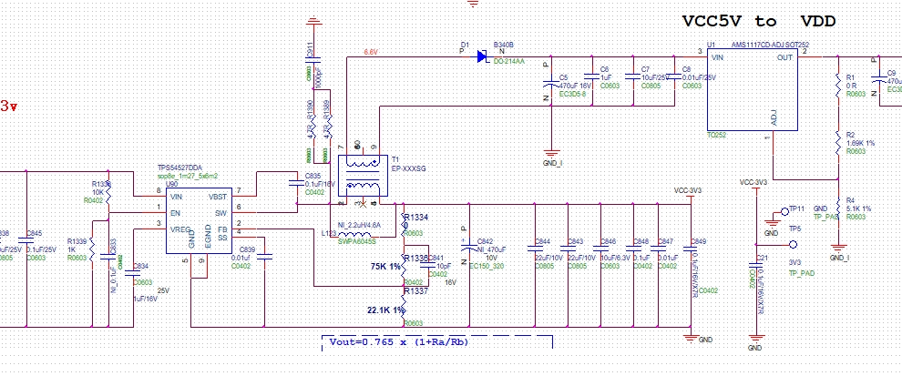

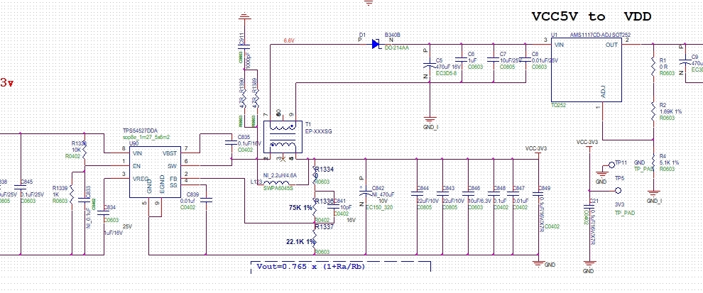

TPS54527: possible for isolated design?
Part Number: TPS54527
Other Parts Discussed in Thread: TPS54308, PMP
My customer tried to use TPS54527 for a dual output  design, one for isolated 6.6V output, and  one for 3.3 non-isolated output. the input is 12V.  please help to suggest if this device can be used in a design like this. if not, please kindly recommend other one-chip solution. thanks.
