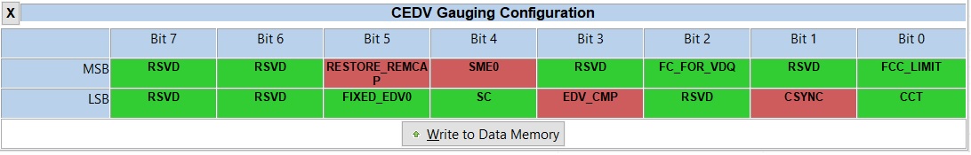

    Here is my CEDV Gauging Configuration:

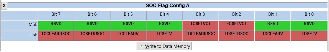

    Here is my SOC Flag Config A:

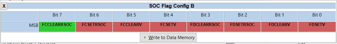

    Here is my SOC Flag Config B:

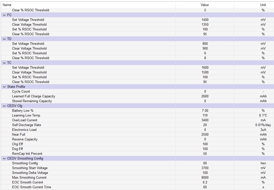

    Here are two images showing My gas gauging Data Memory contents:

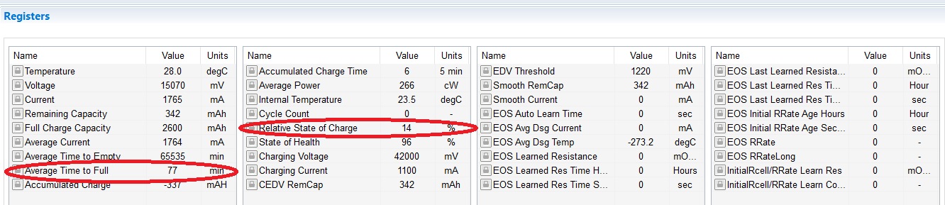

    And finally, here is before and after. Image 1 shows decent RSOC tracking during a charge:

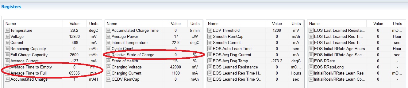

    And here is the issue I am trying to solve. during discharge, The bq loses the values of average time to full and relative state of charge:

  • Hello Brian,
    It looks like you need to configure some parameters in your GG file, the TD, TC, FC, and FD don't match your CEDV voltages. This will cause some of the errors in the RSOC reported because in you soc_config_a block you have selected the these bits to be triggered with RSOC or voltage.
    Also in your CEDV gauging config you have the EDV_CMP bit on which means even though you calculated your batteries specs with the tool, it still might not use them, it may be calculating its own values. See section 2.7.9 in the TRM.
    Make sure you follow the steps for calibration, for the RSOC to be reported accurately the gauge needs to know all your batteries specifications and when you want to terminate charge/discharge.
    Sincerely,
    Wyatt Keller
