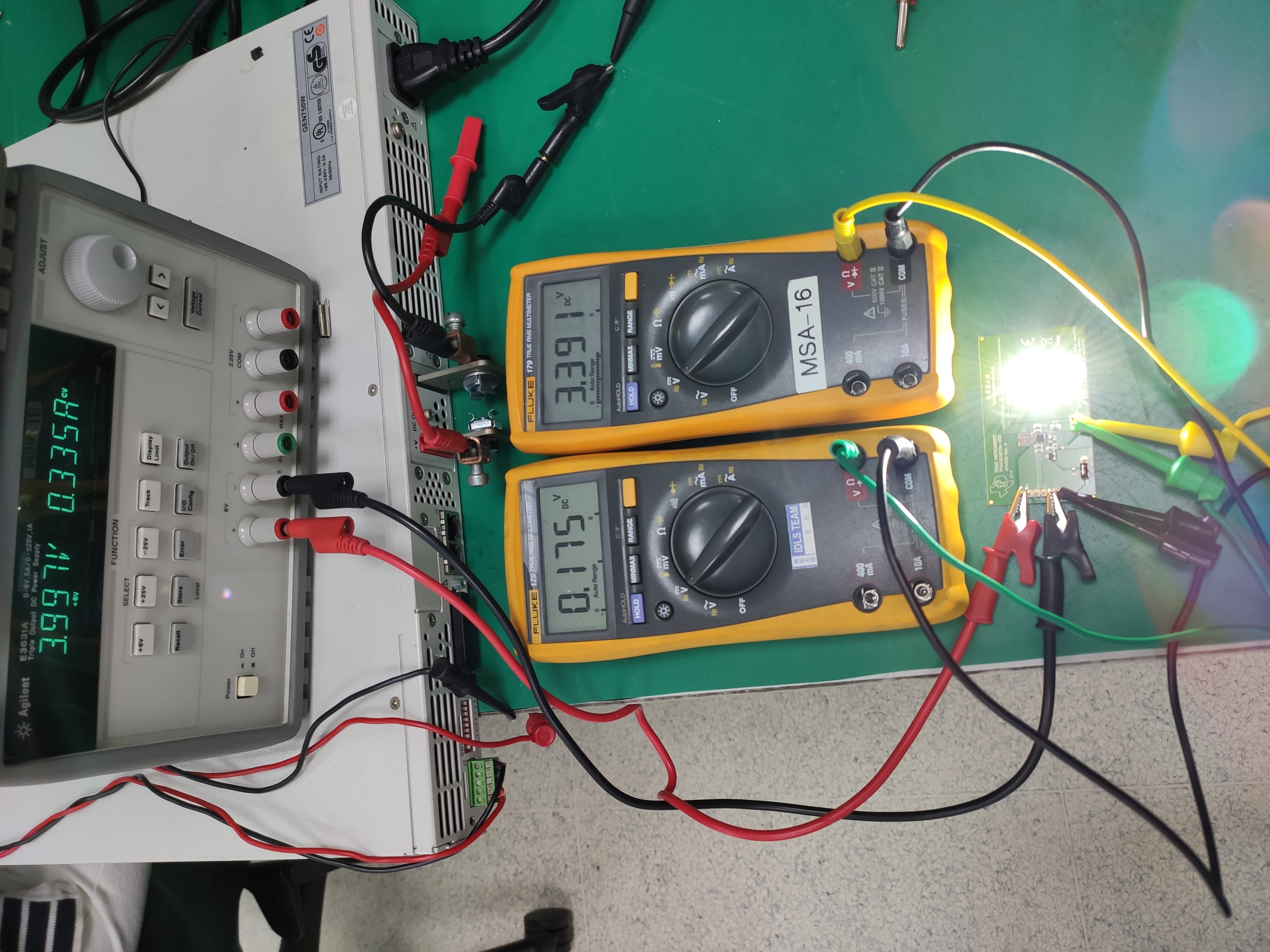

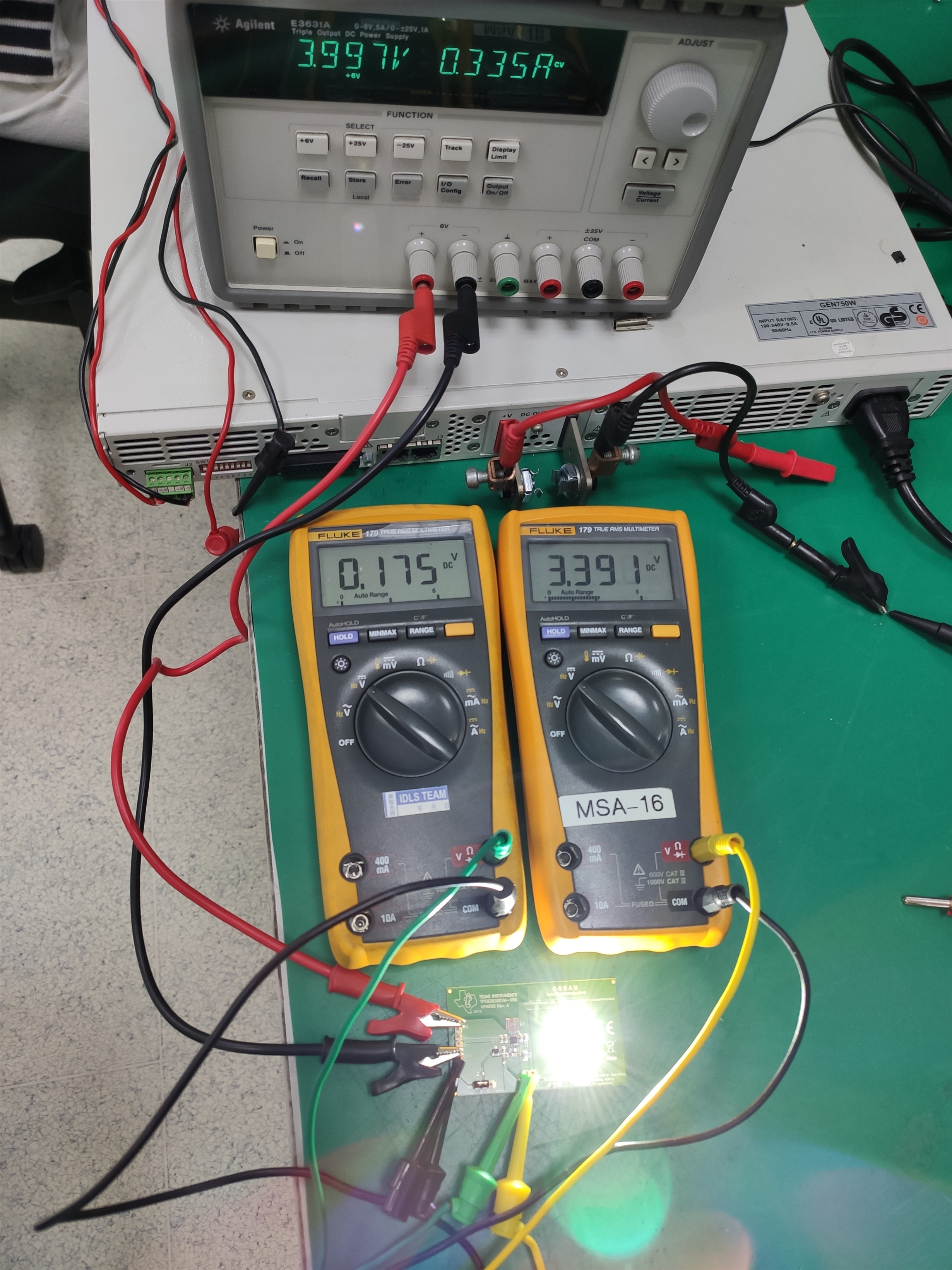

  • Hi Jon:
    I did the test based on TPS63030 EVM. The test result matches the user guide well. For example, Vin=4V. Eff=3.39V*(0.175V/0.51Ω)/4V/0.335A=86.8%.
    I also took a photo to show the setup. As I only has two multi-meter in hand, I just use the measurement result from power source and ignore the voltage drop of cable at input side. (But it doesn't matter for this case, as it only makes the test result a little smaller than real value actually.)
    For the test you did, I don't think it's caused by bad EVM. It could be caused by cable loss, improper measurement, or unstable. May you do the test with same setup? Better with the original LED.  Thank you!
