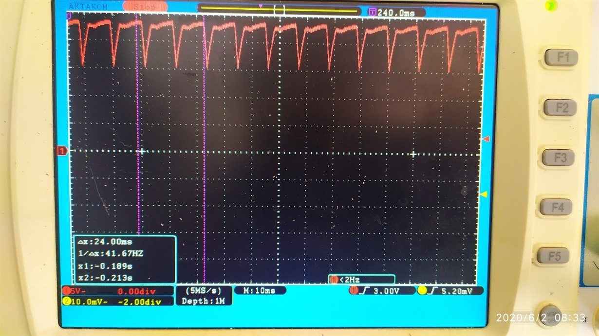

Good afternoon. I make an uninterruptible power supply for a system installed in railway transport. I decided to use the LM5118 chip as a charge controller. An ideal diode controller LM74700 is used as an output diode, ACS712-05 is used as a current sensor. The charge voltage is controlled by the IRLML6346 transistor, which shunts the 1KOM resistor. Management is via PWM from the microcontroller. The main problem is the large current consumption, or rather, the feeling is that for some short period the LM5118 controller which triggers the protection of the DC-DC converter TEP 75-7215WI. For example, I charge a battery with a current of 500 milliamps and a voltage of 28.8 volts. Moreover, the input voltage at Lm5118 is 24 volts. DC-DC converter goes into protection. Or it starts to work in some kind of resonance. I tried to exclude the DC-DC converter from the circuit and connected the LM5118 directly to the laboratory power supply. The power supply starts to ring, the current consumption is also high. I tried to put a choke, a choke and a capacitor between the DC-DC converter and the charge controller. Tried to manipulate the working frequency and ramp of the LM5118. Always one result. The circuit makes a loud ringing. And she has a peak large current consumption. I am attaching to the question the input voltage waveform on the LM5118, the design of the printed circuit board and the printed circuit board itself, perhaps I was mistaken with the wiring. I made the circuit diagram and face values ​​of the radio components according to the proposed TI designer on the site. Which way should I dig, is it a calculation error, or an error in the PCB layout? I would also like to say that such miracles happen only with the battery. The load in the form of a lamp or resistor works correctly, there is no ringing or increased current consumption LM5118. With a resistive load, the circuit works perfectly !!! Where does such self-excitation come from when working on a battery?

  • Good afternoon. Input parameters of the circuit - direct current 24 volts from a DC-DC converter. The output voltage is adjustable from 28.8 (cyclic charge mode of the battery) to 27.4 (buffer charge mode) The maximum output current is not more than one ampere. I was able to defeat the problem. It turned out to be my carelessness. I made a mistake with the calculations and soldered a current-limiting resistor at 0.025 ohms, after replacing it with 0.075 ohms, the circuit began to work perfectly. the ringing disappeared, the current consumption decreased. The unfortunate DC-DC Tracopower TEP 75-7215WI finally became kind and stopped restarting. All this time, the chip was in critical on-off mode, as evidenced by the saw on the SS leg. Accordingly, the circuit was not in the current limiting mode, as intended, but in the continuous emergency on-off mode. I still have to adjust the feedback circuit, but now it’s clear that the circuit is working. One thing I can’t understand is why the inductance is so hot. She is at 8 amperes, SRP1265 inductance is 30uH. Very hot, with a charging current of 1 ampere and an output voltage of 28.8 volts. There is a current reserve. Is it really necessary to take an inductance with an even higher current? And another question, I’m completely confused, how knowing the input and output voltage, the current is to choose the inductance correctly? I tried 30 uH, 47, 100, 120. And the circuit behaves the same. How to calculate it correctly?
