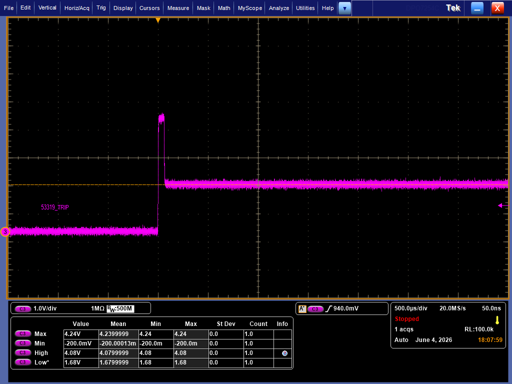

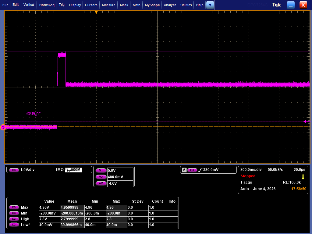

Could you please help check whether the TPS53319 RF pin and TRIP pin waveforms are correct or not? And share why the phenomenon is like this. Thanks.
RF start up:
TRIP during start up:

Frank,
The phenomenon you are witnessing, is the internal current source turning on and then settling out after a short time period during the power up.
