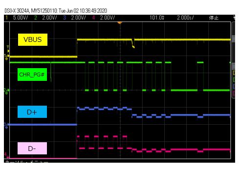

Hi team.
Could you tell me about the USB negotiation?
My customer's circuit doesn't start charging as below.
It seems that it is negotiating many times.
VBUS(Yellow) : 5V/div
CHG_PG(Green) : 2V/div
D+(Blue) : 2V/div
D-(Pink) : 2V/div
I

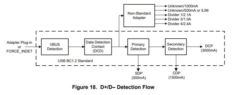

 have a few questions about this move.
1. What's wrong with the circuit that causes this behavior?
2. Does it recognize BC1.2 connection first?
3. Are the following flows checked in order?
 How long does it take to recognize?
5. When the connection is lost, CHG_PG first? Or is USB negotiation first?
