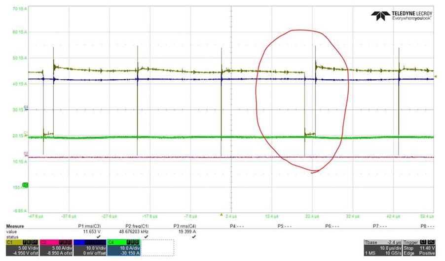

When CC mode test, We control Iout load from 0A~21A. It Hear audible noise at 17A load and drop Vout from 12.6V to 10V. And it happen switching lose as below 2nd capture.
When CV mode test, We control Vout load from 9V ~12.6V. it hear audible noise between 10V~11V of Vout load. And it happen switching lose as below 2nd capture.
According to the calculation tool, there was no problem of phase margin but does it have some problem on real board ?
How to improve switching lose.
could you let me know any advise.

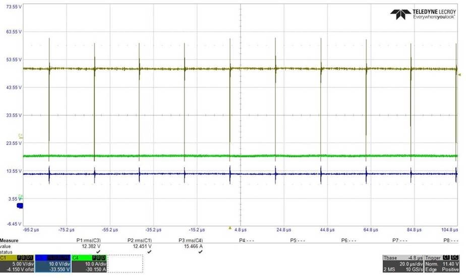

Test condition
Vin: 12.9V
Vout: 12.6V
Max current: 21A
Yellow: SW1
BLUE: Vin
Green: Iout
Good working up to 16A load.
Yellow: SW1
BLUE: Vin
Green: Iout
Happened switching lose
