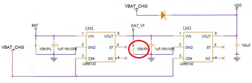

We use LM66100 to compare BAT & 3.3V
Vin--BAT voltage (3.2V~2.7V)
CE--3.3V (3.135~3.465)
When BAT = 3.2V 3.3V = 3.135
This will encounter VCE-Vin <80mV Vin-VCE <250mV
May I ask if the IC is in DIODE mode (off) or MOS mode(on)?
thanks

Welcome to E2E, a downside of the LM66100 is when voltages being applied on the VIN pin and CE pin are very close in value. I the state you mentioned the device could be either OFF or ON. We con only guarantee the ON or OFF state of the device once the difference in voltages exceed the thresholds described in the datasheet for VON or VOFF.

Dear Andy Robles
I have a question.
When no BAT at VIN, only 3.3V input.
Is it okay if VIN floats?
thanks
Leaving pins floating is usually never a good idea. Since the behavior of the device is dependent on the voltage value at the VIN and CE pins we would not be able to guarantee its characteristics if the voltage is left floating.
