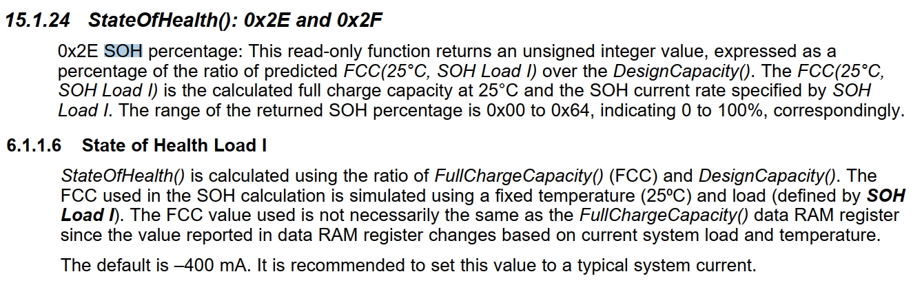

    For the remaining life(SOH), I checked what customer is looking for. Could you support the following questions?
    1. Calculation formula
    The customer understands from the data sheet below that SOH is calculated by dividing the charge capacity by the design capacity, and applying a correction(compensation). However, customer doesn’t know what kind of correction(compensation) method is used in it, so customer would like to know it. Especially, could you tell us how the parameter of “SOH Load I” affects to the correction(compensation)?
    2. Update condition of SOH
    Could you tell me what is the condition for updating SOH? Is it updated every certain time, or is it updated when certain conditions of discharge and charge (cycle count etc.) are met?
    Customer faces an issue that Remeing Life becomes less than 100 even though the cycle count is 1 with BQ27542-G1.

  • Hello Yamaguchi-san,
    SOH is computed by the same engine that computes RemCap, however we fix the load current so it does not change via the dynamic learning during the discharge.
    SOH Load I will be a constant variable that is used in a RemCap simulation.
    The formula for the SOH should be the following: SOH = (Design Capacity)/(FCC Simulated with SOH load 1)
    I believe the conditions would be updated whenever a new FCC is calculated after a cycle.
    It really depends on the Qmax and Ra tables.
    https://www.ti.com/lit/an/slua364b/slua364b.pdf?HQS=slua364-aaj&ts=1591998301457&ref_url=https%253A%252F%252Fwww.google.com%252F
    This app note shows a RemCap simulation example. The SOH is the same thing except it uses SOH Load I instead of what we use in load mode/select.
