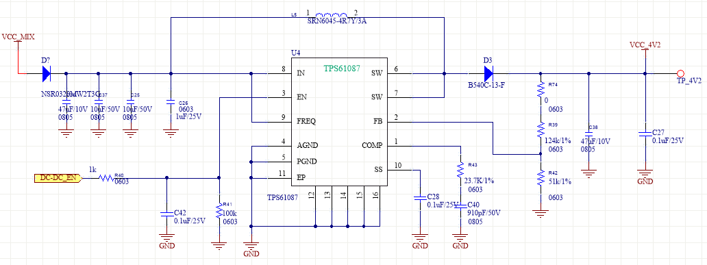

Dear
I designed SCH with TPS61087 . when the load is light, it can work normally, but when I increase load , it can't Boost . can you give me some advices?
I am looking forward!
Dear
Dear Sir,
What is your Vin, Vo and Io? The peak switch current of TPS61087 is around 3A.
