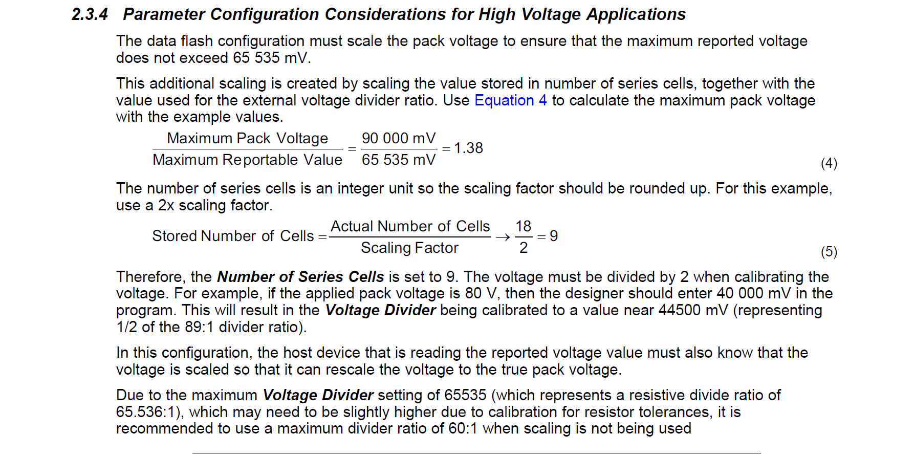

hello i want to using this fuel gauge ic in my ev vehicle bms system,but i want to ask that
i saw in pdf features Accurate End-Of-Service (EOS) Determination for Batteries in Rarely Discharged Applications, it saying only for rarely discharged applications
but i m using in my ev that will discharged daily or in two days.
so i asking is that ok with that .
will it calculate accurate all the parameters?
battery voltage = 70, i am using it on low side of battery pack.
