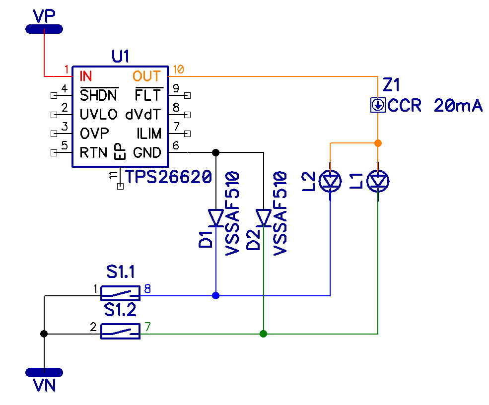

I am required to power two LED circuits with a single TPS2662 eFuse using a circuit similar to the simplified one I have attached below. Only one of the two LEDs will be illuminated at any given time.
Will the diodes in the ground path cause any issues with the functionality of the eFuse?

    Diodes in the ground path will not cause any issue to the device functionality. Please terminate the other pins appropriately as per the description in the datasheet.
    Can you let us know the application/ product details. ?
