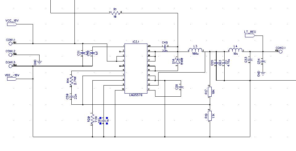

I have a typical LM25576 circuit, which is a new iteration of a previously working design.
The circuit fails to start and I have found that the IS pins, 15 and 16 are being shunted to PGND. I was hoping to get some help in undrstanding why this is happening.

    The IS pins should have a voltage very close to PGND since they are connected to PGND through a low-value current-sense resistor. Can you please share the schematic and some waveforms to show what you've tried and how exactly the part isn't working?

    Yes sorry, I was looking for shorts rather than measuring the resistance. I think I fried the chip when moving it from another board, I have put in a new one and getting some results.
    It appears the circuit is working as designed, but the switch output is oscilating, at about 3Mhz it seems. I have attached the circuit I am working from, not included is a voltage multiplier that goes off screen.
    I believe I have used the correct compensation as suggested in the datasheet. I might roll back to a previous PCB and see if an error has occured since then.
