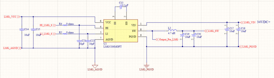

    Attached should be a capture of my test schematic.  I have more parts on order and will update once I've run a couple more tests.

  • Hello Nick,
    Looking at the schematic, I don't see too much problem since it follow nicely as our reference design. One improvement can be made is by using more smaller ceremic caps for the power loop instead of two large ones to widen the traces for the power loop and reduce the inductance. However, since the overshoot is very reasonable, I don't think it's a big problem here.
    Also for the resistor you are using, the current level should be fairly small. For now, I think populate the bypass cap for IN pins and repeat the tests with new parts while monitoring the temperature would be the next step.

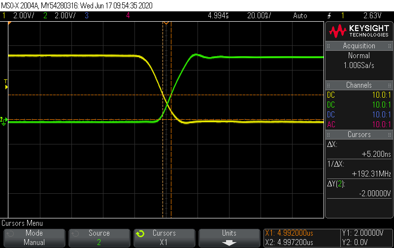

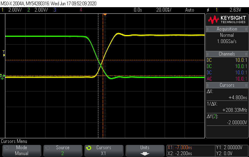

    I populated another three test circuits, with input bypass caps, and saw similar behavior.  Input pulses were configured for 4.8ns (HI) and 5.2ns (LI) deadtime.

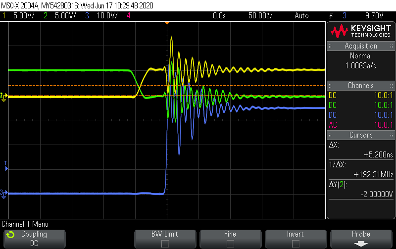

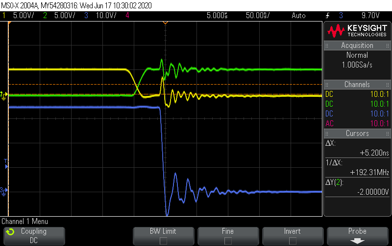

    Below should be screen captures of my pulse inputs and the first circuit switching at 34Vdc. Pulse deadtime measurements were taken directly from the signal generator.
    I noticed the high side switch features ringing with much larger amplitude than the low side switch.
    Note, yellow is HI, green is LI, and blue is SW.

  • Hello Nick,
    There are two problem I could spot here. First one is the dead time is too short and might have chances to cause shoot-through. You might leave the dead time to be 20-30 ns since there will be delay mismatching in other component. Second one is the power loop inductance. Looking at the switch node waveform, it seems that there will be a large power loop inductance. The HI, LI and SW ringing could be another reason device fails. While using single layer is increasing the inductance, you might still want to take a look at the layout and minimize the length and widen the power loop trace.
