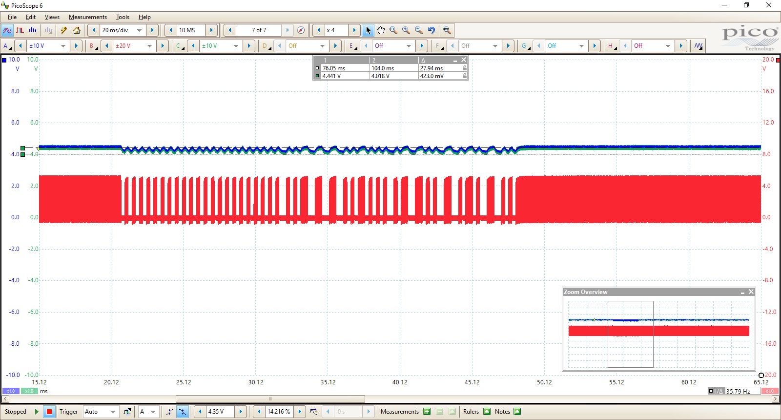

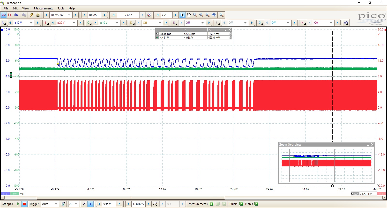

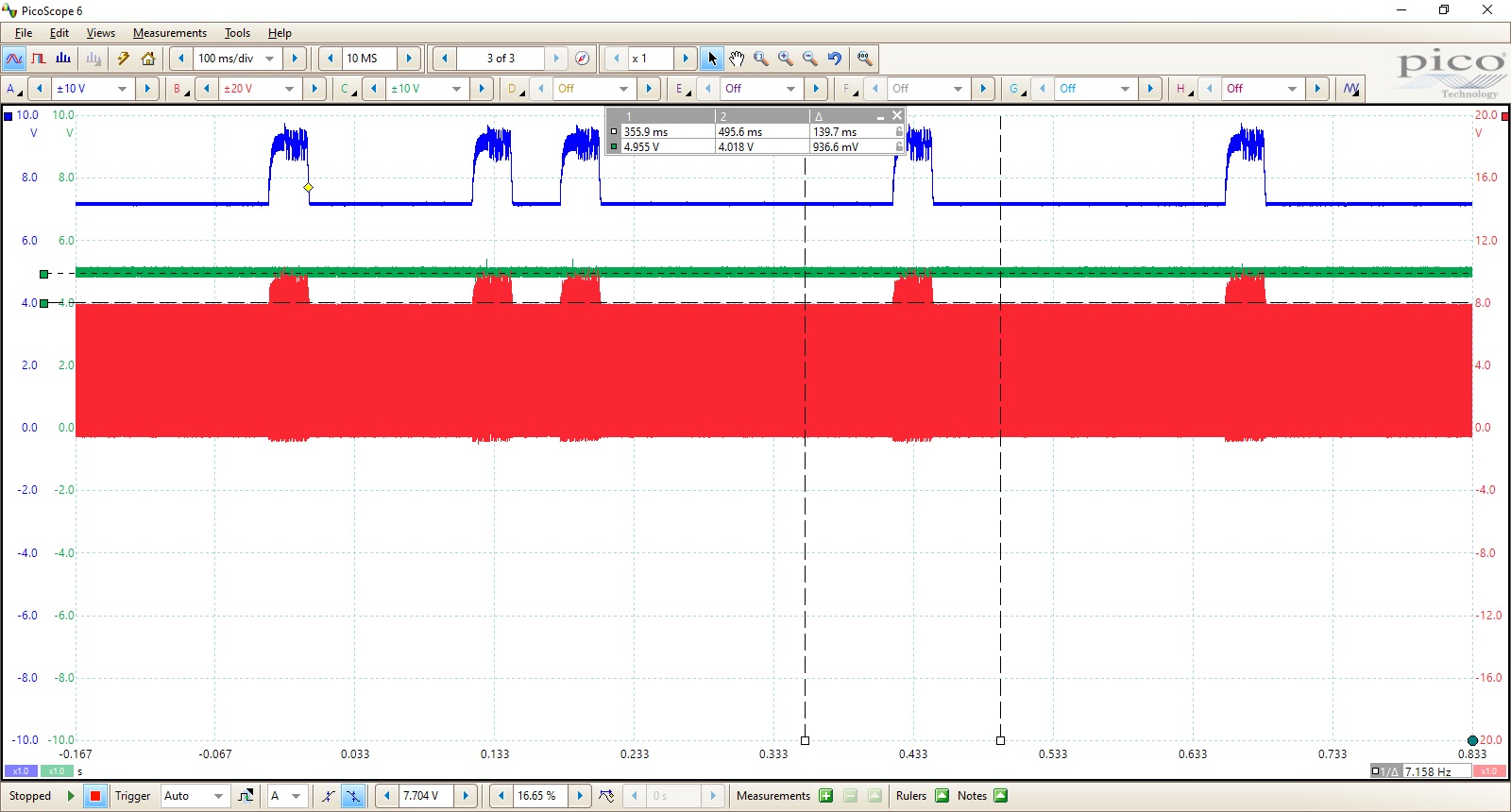

I’m working on a new design using the BQ51013B wireless charger.  I’m having trouble getting the output current over 400mA.  I’ve included scope shots of no load, 150mA and 400mA.  Up to 150mA the rectifier voltage stays above 5V during communication, however between 150mA and 400mA the rectifier voltage sags below 5V during communication and drops below the UVLO above 400mA.  Looking at page 11 of the datasheet I can see that the output current should be limited during communication but it doesn’t look like the rectifier voltage drops.

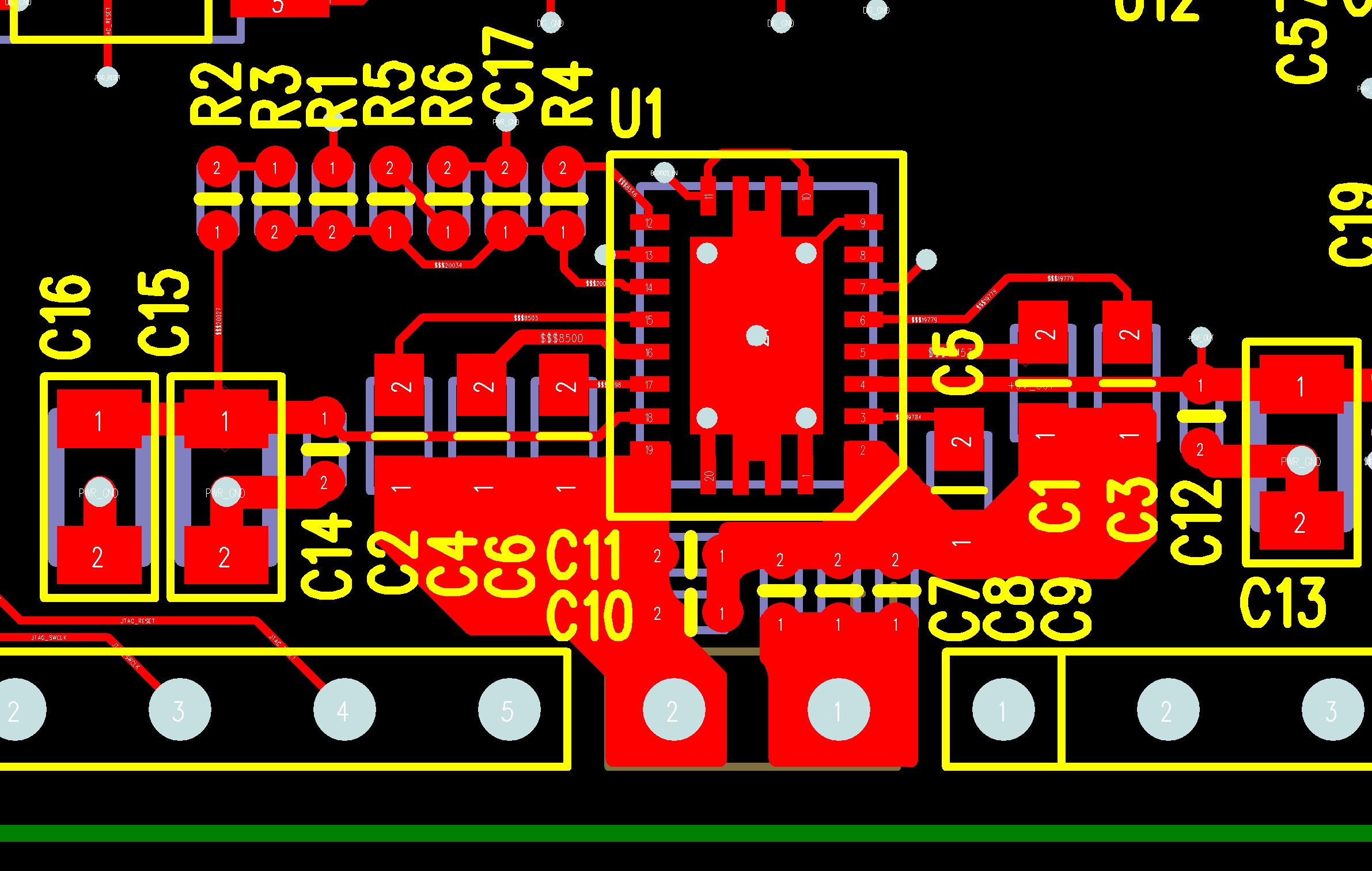

I followed the procedure on pages 29 and 30 to measure the inductance of the coil and calculate values for C8 and C10.  I then adjusted the value of C10 to get the best connection to the TX.  I also lowered R_ILIM but that didn’t help much.

Layout

    The schematic looks good.
    Do not see any problem with the waveform.

    2.) Thermal limit -- device is getting too hot and limiting current.  PCB looks good but check thermal rise of the device.

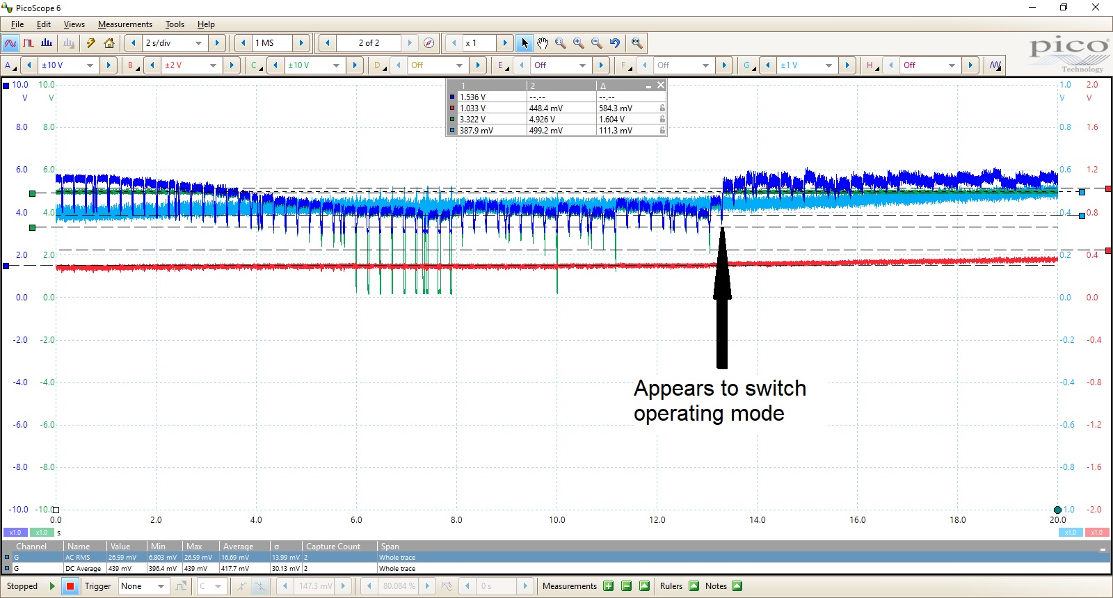

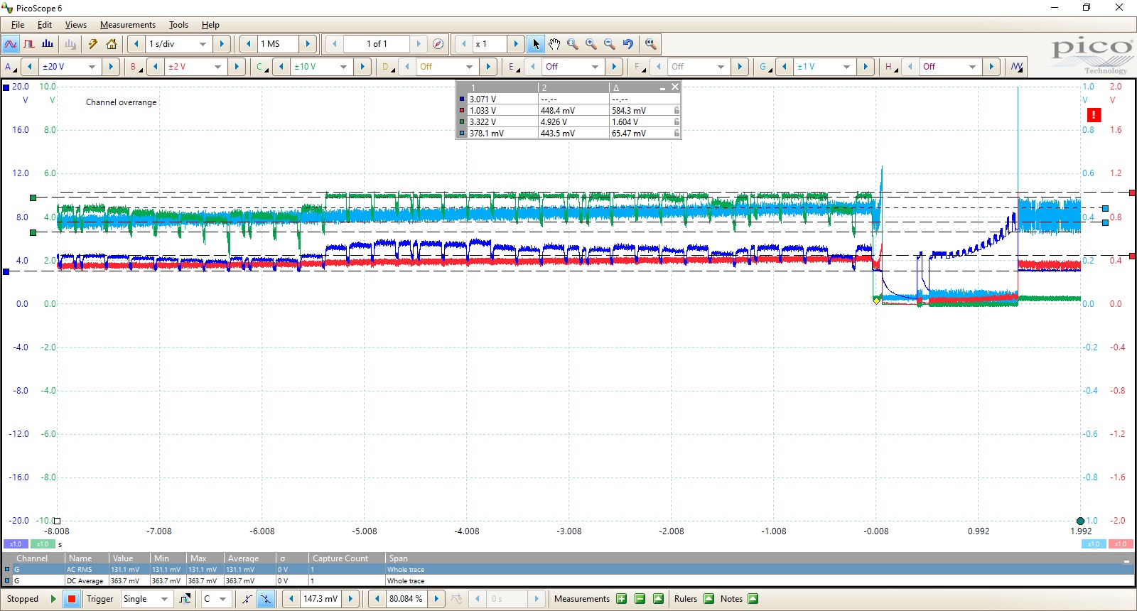

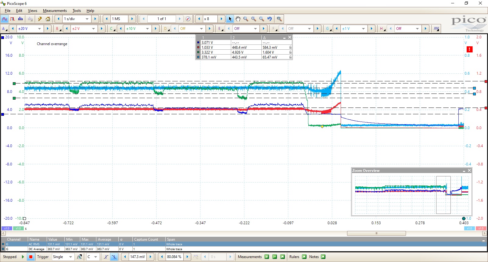

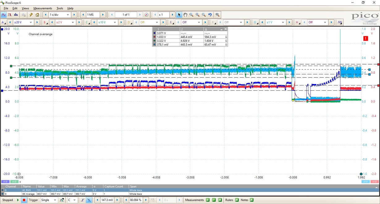

    1)  I measured the voltage at the I_LIM pin and it is not close to 1V.  I started at 350mA and increased the load current to 443mA at which point the output shut off.
    Blue = RECT, GREEN = OUT, RED = I_LIM, LIGHT BLUE = Load Current 1A/V
    The voltage at I_LIM rises to about 448mV when OUT turns off, RECT is sagging down to 3V
    I then changed R_FOD to 150ohm with R1 = 100.  Starting at 350mA load the output drops as before, however around 400mA the output begins to momentarily shut off.  I varied the load current above and below 400mA and then the output suddenly jumps back to 5V and is regulated.  At that point I could increase the load further to 550mA before the output completely shut off.  It appears that there is a problem with the dynamic rectifier control and adaptive communication limit.  I'm not able to get the device to switch between Iout < 300mA and Iout > 300mA operation, and it won't startup in the Iout + 50mA mode.
