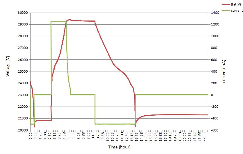

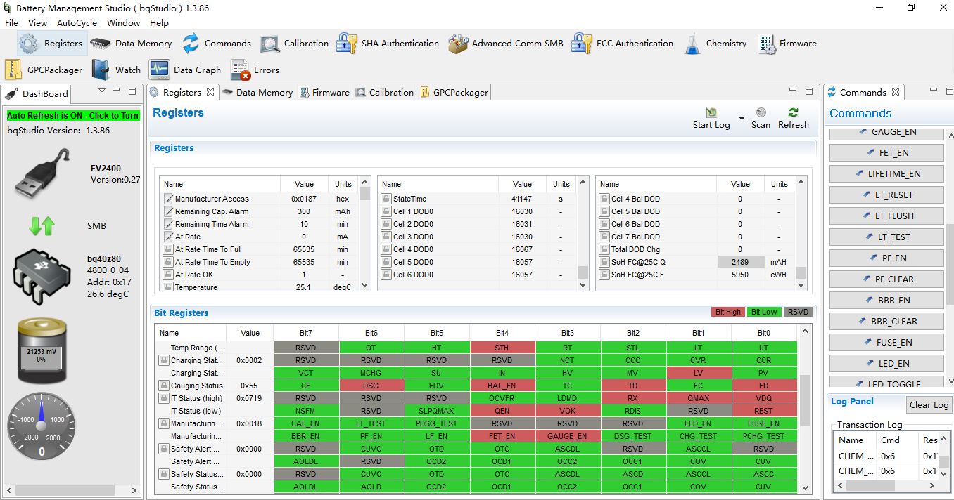

Dear TI‘ Team
I have failed twice when doing learning cycle, both are stucked in the step discharging to empty and wait VOK clear.
My application is a 7S1P pack, the battery is EVE ICR18650-26V , the GPC match the ID 1783 as the report show.
Can anyone help me to check which step or details gose wrong?

the screen shot of BQstudio is:
and the cycle curve is:
