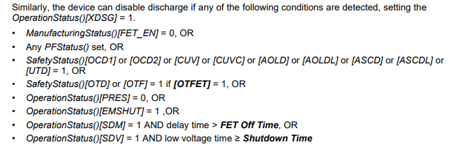

  • Make sure you send a FET_EN command in the bqStudio so that both DSG and CHG FETs are controlled by the bq40z50.
    Andy
  • Hi Andy
                        I am not  saying that I am not able to charge or discharge...... Please read my query again
    Eeswari.
  • Hello Eeswari,
    The FET_EN command will switch the FET controls to the firmware so you don't need to manually change anything in bqStudio.
    The gauge should act on it's own without the need of manual bqStudio commands if you have configured it for your application.

  • Hello Eeswari,
    Are you trying to use the commands to control the FETs manually? Once the device is sealed you can't send manual FET commands.
    If you are having problems with the operations the firmware is doing after you seal the device can you send the .gg file so we can see your new configuration?
    Sincerely,

  • Hello Eeswari,
    Was the log file you shared of the test with protections disabled? They appear to be enabled from the log.
    The FET_EN must be 1 for the FW to be in control when you are in UNSEALED mode. Make sure the bit is set before you enter the sealed mode, if it is set to 1 then the FW is in control and it should control the gauge the same if it's in sealed or unsealed modes.
    Both of the FETs are turned on manually when you enter SEALED mode, when you enter SEALED the FW takes control and shuts them off because all the protections are enabled.
    I noticed your CUV counter is increasing still, you are most likely triggering this protection and the gauge then disables the FETs.

  • Hello Eeswari,
    From the log files you provided in the last post the protections are still enabled. This is from your .gg file:
    Also try changing your FET options to 0x00, one of the settings you have disables the CHG FET.
    By disabling the protections it will let us narrow down what the issue could be, do you have a different log where you tested without the protections enabled?
    From the TRM, it can be confusing to read but it states that if the status is 0, then sending the command makes the FW in control, by sending the command it would switch to 1, red on the dashboard.

  • Hello Eeswari,
    I have been reviewing your logs, it looks like you have met one of the conditions to trigger XDSG and XCHG from the following snippet of the TRM:
    The PRES bit in your operation status A register is at 0, meaning it will always set XDSG and XCHG when FW is in control. You will need to connect it to the pack- as outlined in the EVM user's guide or change the NR bit depending on your application.
    Double check your FET options as well, this could trigger the XCHG after the PRES bit is fixed.
    I also noticed some of your voltages were negative in your trail1.gg file for the shutdown voltages.
    Once you fix the PRES bit, you should be able to enable the protections and let the FW be in control without XDSG and XCHG setting.
    Sincerely,
    Wyatt Keller
