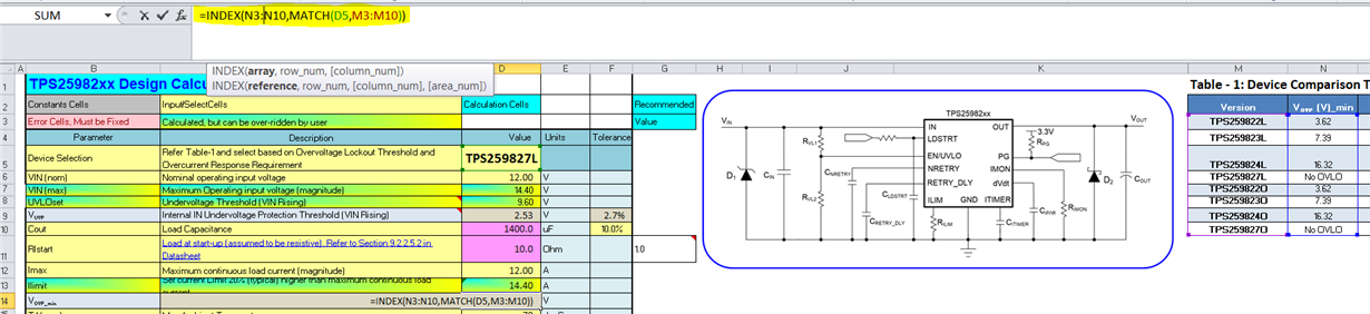

Hi team,

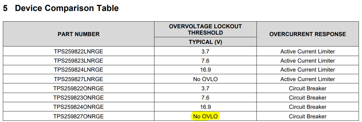

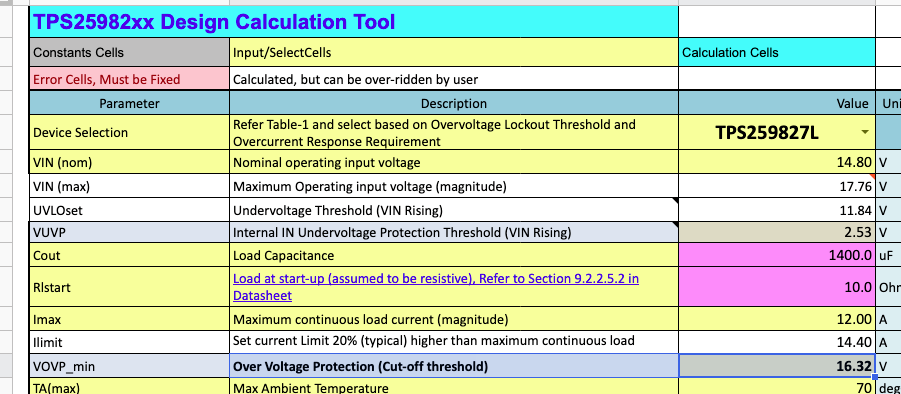

My first time designing a board and I have been trying to calculate the values based on the calculation tool. With the TPS259827L, the Over Voltage Protection is only at 16.32V while in the data sheet they should be No OVLO. Am I missing something?
