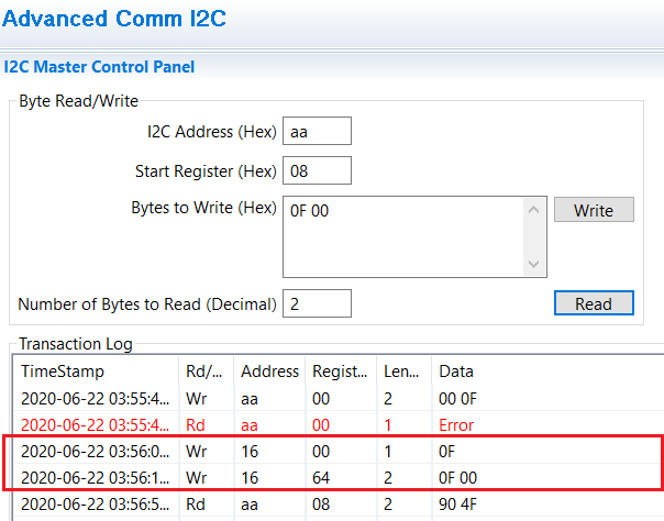

  • Hi  Markus
    You need to send the two commands below to exit from ROM mode.
    W: 16 00 0F
    W: 16 64 0F 00
    I have checked using the Advanced Comm I2C Window in the bqStudio.
    Basically, I can exit from the ROM mode after I send these two commands.
    Andy
