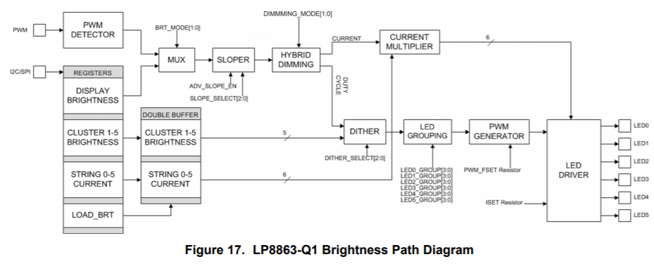

I understand that register setting for brightness control on LED0~5 individually are below.
⇒LEDx_GROUP, CLUSTERx_BRT, LEDx_CURRENT, LOAD_BRT_DB
Please let me know about two points below in the case of overlapped a few register setting;
①Are Sloper and Hybrid mode valid on Display brightness only?
 When setting CLUSTERx_BRT for LED0~5 individual, are Sloper and Hybrid mode not valid?
②When already set CLUSTER_BRT and LEDx_CURRENT for individual brightness control, are Display brightness and DImming_MODE setting influence to control?
