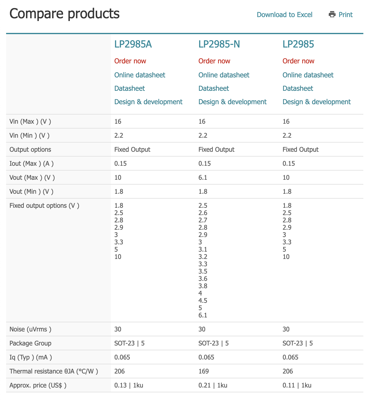

What is the difference between LP2985AIM5-... and LP2985A-... ?
Both are available and seem to be exactly the same product (although there are two different datasheets).
What should I specify in the BOM for a new serial production PCB?
  • Hi Eckhard,
    Here is a summary of the differences:
    The LP2985AIM5 is the LP2985-N it has a lower VOUT max but has more voltage offerings and better thermal performance.
    I made the table above with our LDO quick search tool which can be found here:
    I hope this answers your question.
