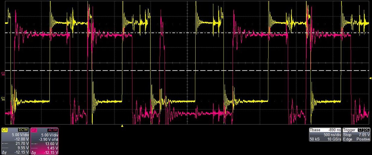

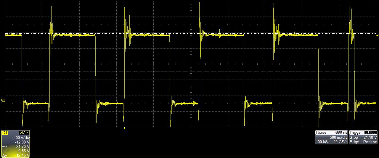

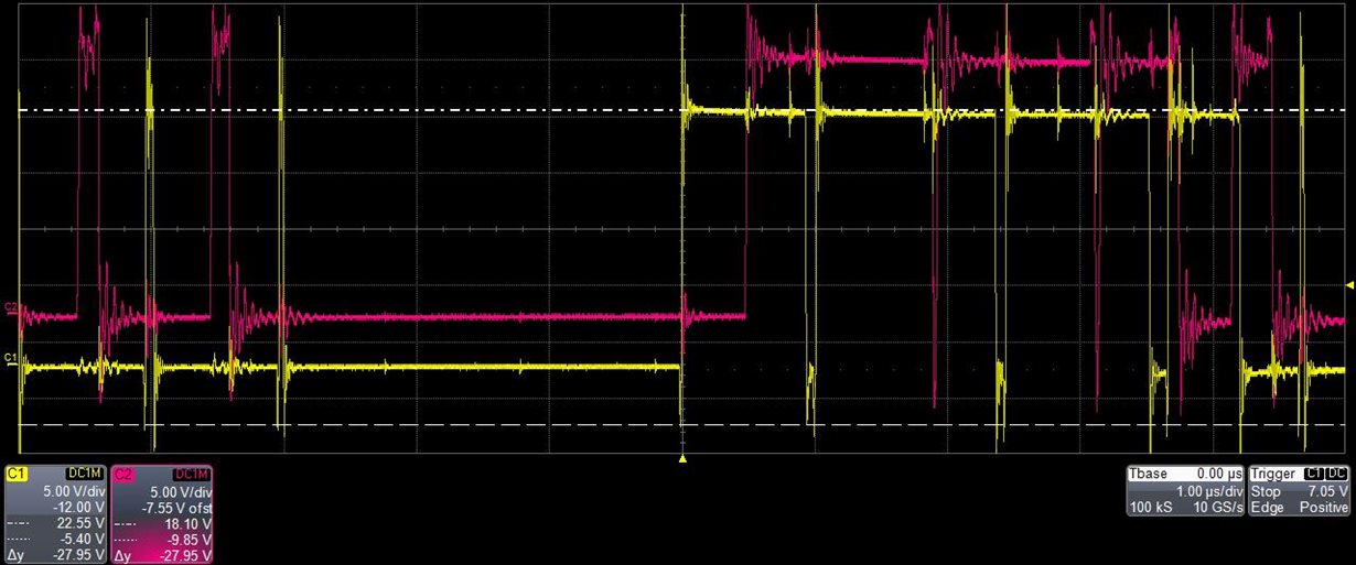

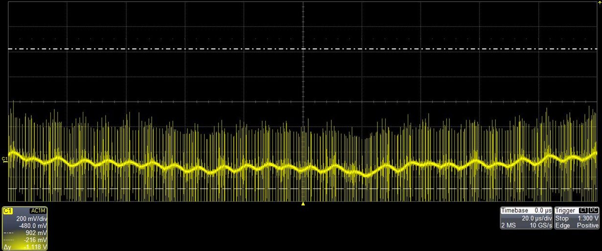

    4. Attached is part of the schematics (the 2-phase 12V/40A power supply unit). Waveforms are attached also. Please note that I used a standard probe grounding clip
    - Trace 1 is the SW1 voltage of driver U400 driver 1 in case the output voltage is OK. Note the sudden change in duty cycle.
    - Trace 2 are the SW1(y) and SW2(r) traces in case the output voltage is OK.
    - Trace 3 is the rising edge of SW1, output voltage is OK
    - Trace 4 is the SW1 voltage in case the output voltage is NOK (approximately 10V instead of 12V)
    - Trace 5 are the SW1(y) and SW2(r) voltage traces in case the output voltage is NOK.

  • Hi
    pls my suggestion
    1. it looks only Vo have electrical cap , which will easy to get noise and go into the current sense PIN(VOUT1, VOUT2), suggest put more ceramic cap which is low impedeance at high frequency can help filter the noise at output
    2. short L402, the two stage of L C filter will not good for the loop stability
    3, I can't see the compensation value very clearly, use caculator to see whether the loop compensation is good, and you can also increase the Ccomp and decrease the Rcomp to reduce the bandwitdh to see any help
