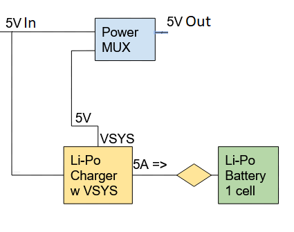

I want to make simple schematic, where a battery charger connected to the 5V bus. It should work like an UPS, I need 3A from charger back to 5V bus.
The battery charged in normal operation mode.When the power on main bus going down, charger will start to provide the 5V from the battery (OTG mode).
You can see the structural scheme below.
Pleliminary i found, that BQ25895 looks good. But i can't found how to connect OTG and VBUS pins.
I see that BQ25892 has requried functional mode, but OTG current are lower - only 2.4A. So i can't use it.
Please recommend me the solution for this case. If it'll be based on BQ25895 it'll better, but different chargers we can use too.
