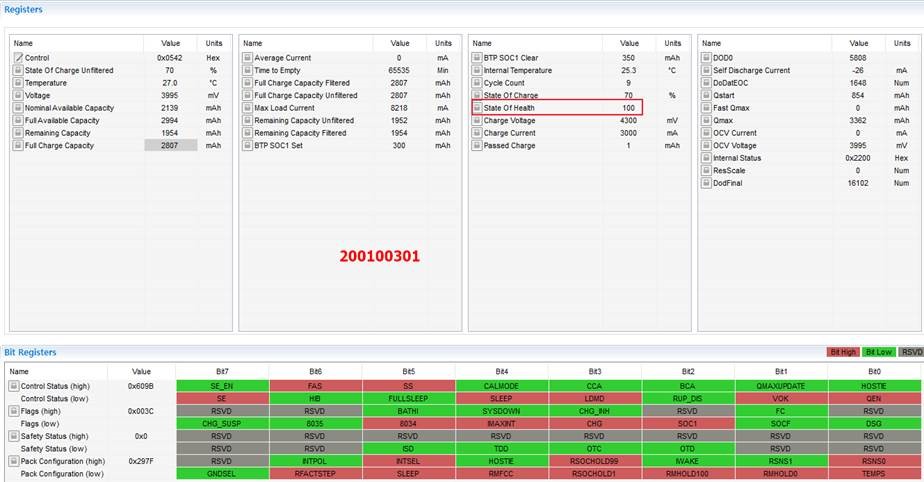

They are using FCC value for SOH.
But there are some problem SOH Value using FCC value.
When FCC value is 2807 and SOH is 100% as 1st capture.

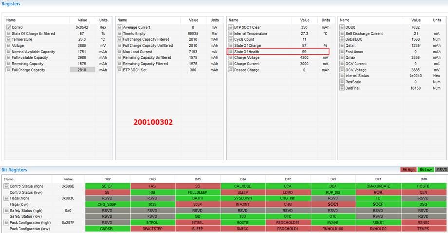

When FCC value is 2810 and SOH is 99% as 2nd capture.
both case is not correct SOH value.

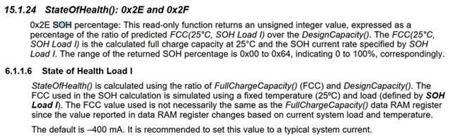

    The State of Health gives your batteries age as a percentage, or basically the percent of the design capacity you can achieve over time.
    From the snippet you shared: 6.1.1.6 of the TRM, the FCC value used in the SOH calculation is based on a set load and temperature to prevent SOH from jumping during discharge cycles. the FCC in the SOH calculation is not necessarily the one in the registers you're looking at.
