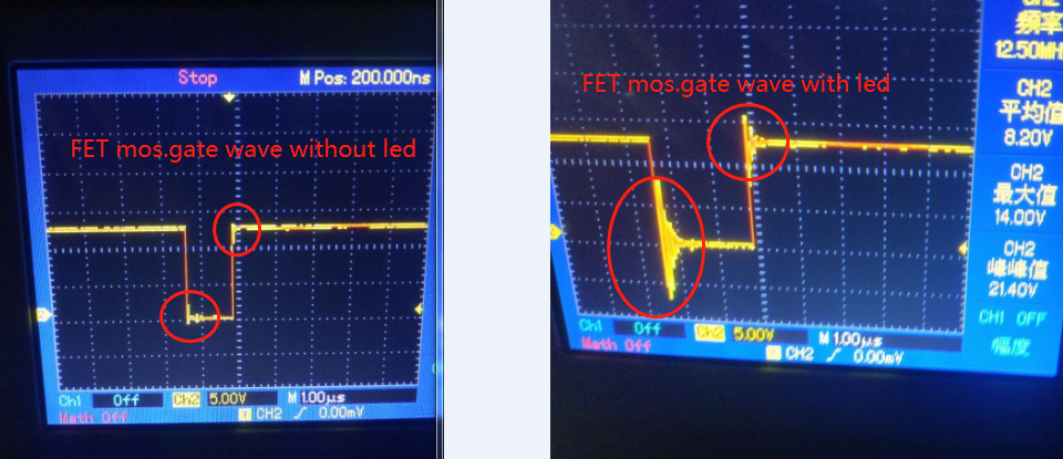

hello ,I recently tried LM3409 FET dimming again,It was found that the change in lamp brightness did not match the input PWM duty cycle, and there was a sudden change in brightness.
I first check the input PWM waveform,It is found that the load will affect the FET MOS waveform. Is this the reason why the lamp dimming is not soft enough?Is there any way to solve?

    I suspect the 'noise' is being picked up the the scope probe.  One picture is without current, the other is with current.

    This is a switching LED driver, there will be noise.  How are you connecting your scope probe to the circuit?  Is you LED load close to the output?  Where is the shunt FET located?  Do you have an output capacitor?

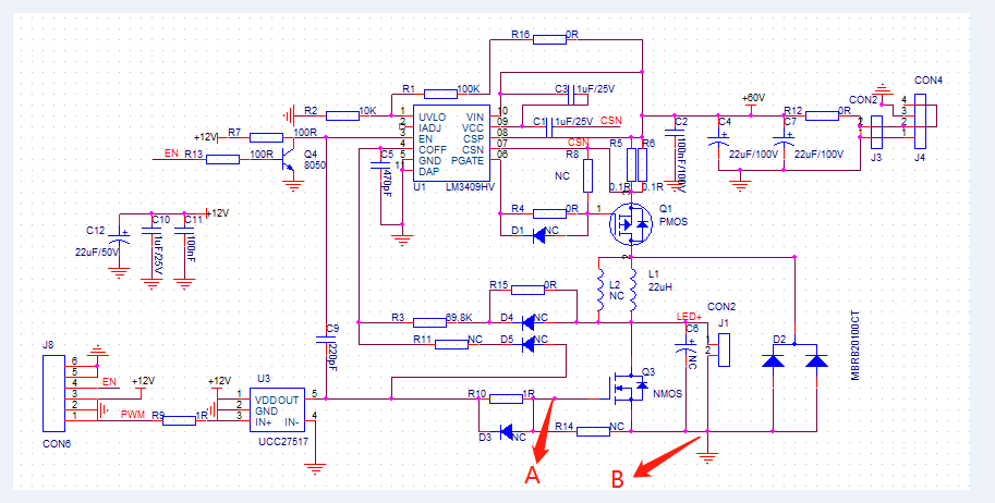

  • hello,I test point A and B.
    My input PWM duty cycle is 0->27%->0 cycles, the duty cycle changes the same unit every time (25MS changes once, each change is about 7nS pulse width). It was found that there were areas of bright and dark during the change of the brightness of the lamp bead, so I checked the NMOS waveform and found that there is noise with and without LED. I don’t know if this noise caused the brightness of the lamp bead to change softly.
    "How are you connecting your scope probe to the circuit?"  I mean how are you attaching the oscilloscope ground and probe tip to the circuit?  I don't believe the ringing you are observing is causing a light output issue.

  • Hello, I lead a small wire at the negative end of the lamp bead, and then the oscilloscope probe directly measures the NMOS G pole. I don't have an instrument that can measure the current waveform. If the noise does not affect the brightness of the lamp beads and there is a sudden change, where can I start to analyze the problem. The mutation occurs only in a small area during the entire dimming process.

    Do you have a probe ground you are using or are you using a small loop connection to the gate?
    You can also look at the voltage across the current sense resistor.  You cannot use the scope probe ground clip, you will need a low inductance connection to measure without noise pickup.  The loop created by the probe ground will allow too much noise in the measurement.

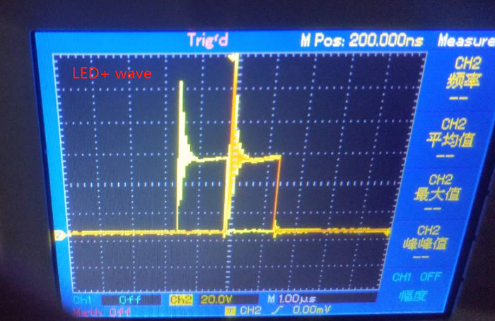

  • hello.There are many oscillating waves at the beginning of the lamp when there are waveforms at both ends of the lamp bead (the LED positive picture on the first floor). This situation does not occur if you use EN dimming. When measuring with an oscilloscope, I measure in the same way. Obvious shock waves can be found with and without lights.
    Because I don't have this LM3409 DEMO board, can you use the DEMO board to measure the standard waveforms of the NMOS G pole and the LED+ wave?and  show me the measurement picture.

    EN dimming turns the gate off and on, the inductor limits the slew rate of the current so it will be much less "noisy".  Shunt FET dimming is shunting the LED current through the shunt MOSFET, the transition is fast and will cause high di/dt which will be pickup up in a scope loop.  I recommended looking at other waveforms and have not seen results.  If the light is changing the current, most likely, is changing.  If the output current is correct then the duty cycle may be changing, this can be see by the voltage across the LEDs.
