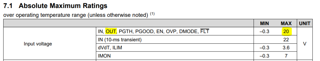

Could you kindly advise the abs max of Vout without Vin ?
In my understanding, even if Vin is not applied, abs max of Vout is the same in the datasheet.
Please let me double check.

    You are right ! The Abs Max rating of Vout for TPS25942A with  or without Vin is the same as mentioned in the datasheet.
    If Vout is a function of Vin, the datasheet spec would have been something like 'Vin + 0.3V'.
