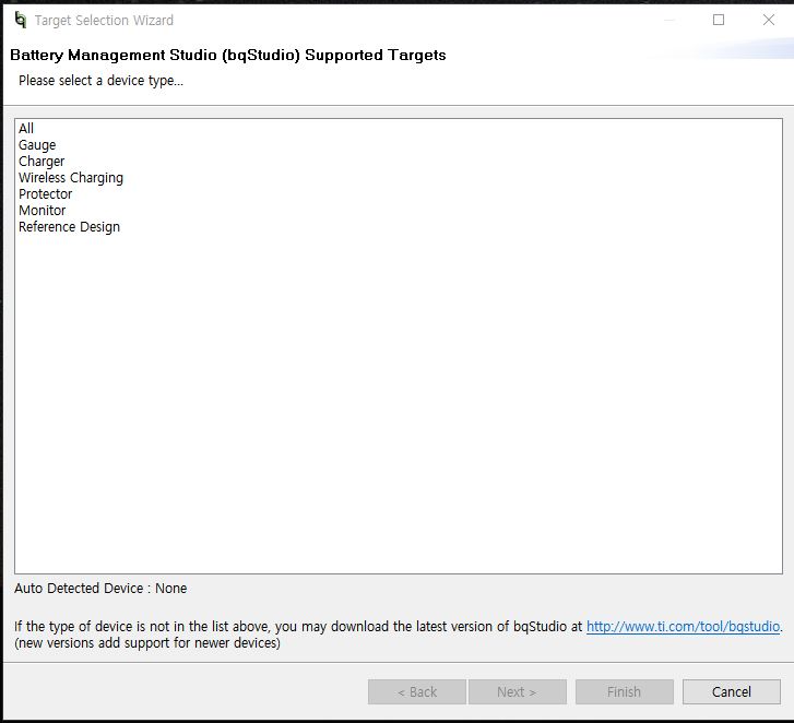

I want to do some tests on the BQ25169EVM but I found there's no BQ25619 in the "Battery Management Studio" software. What should I do? Advanced thanks for any answers and helps.

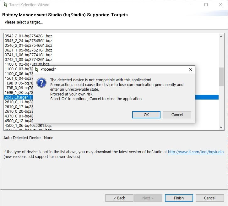

Sorry about that. Please download the attached file and save into C:\ti\bqstudio\v1p3p86\BatteryManagementStudio\config, assuming you used the default install settings for BQStudio.
Jeff

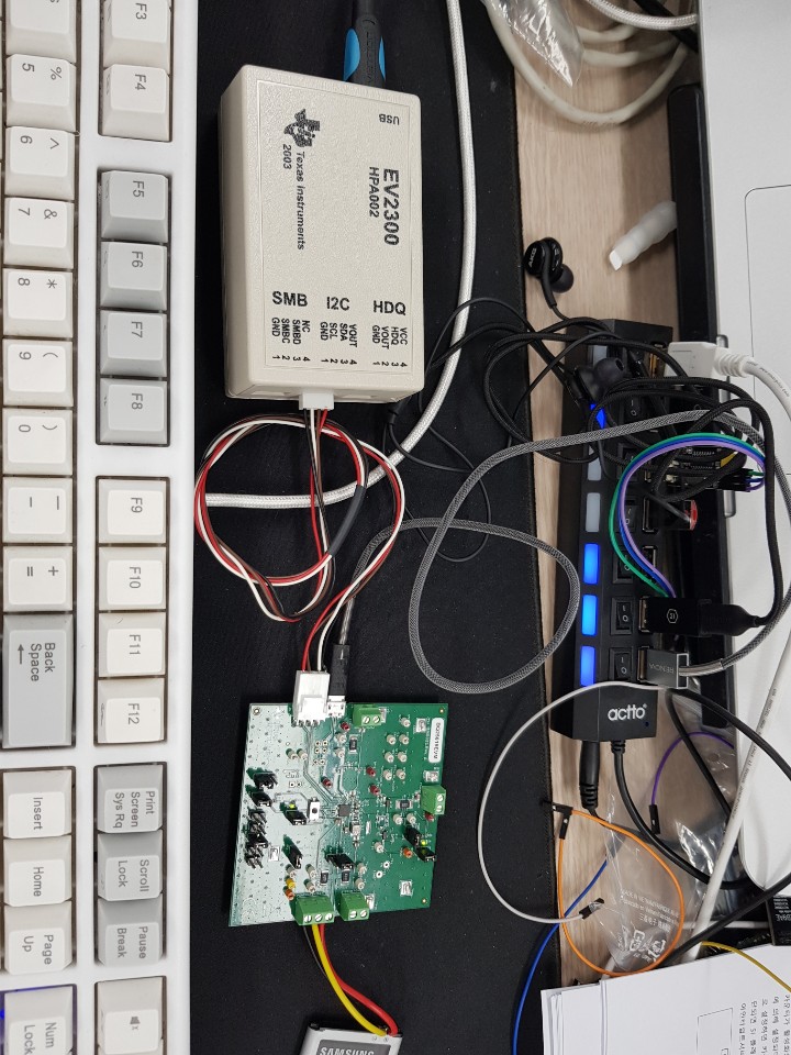

Jang,
Have you used the EV2300 with your current PC and with other TI EVMS? We have seen recently that the EV2300 is not consistently compatible with Windows 10 PCs. Below is an e2e thread with drivers which might work but if not, I recommend getting an EV2400.
https://e2e.ti.com/support/power-management/f/196/t/878098
