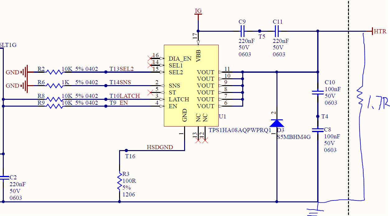

Hi  Experts:
I'd like to know the condition which could trigger the auto - reverse protection in TPS1HA08-Q1, as the description in datasheet ,
"In the reverse battery condition, the switch will automatically be enabled (regardless of EN status) to prevent
power dissipation inside the MOSFET body diode. In many applications (for example, resistive load), the full load
current may be present during reverse battery."
Currently , customer do the test that reverse connecting the 12V on the device , and found the 0.4V voltage drop from Vout to Vbb, it seems the function is not triggered and the reverse current go through the internal body diode.
Please look at the below schematic , the SEL2 is connected to ground by resistor
