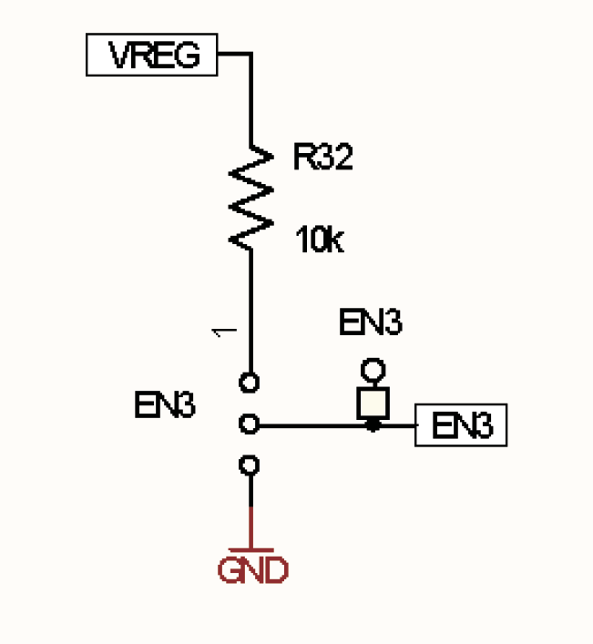

TI Team,
The data sheet says this in the pin description section: "...This pin has current limit-protection; do not use it to drive any other loads." However, the EVM (snippet below)shows that the pin can be used to drive EN3 through a 10k resistor:
The EN3 pin current looks to be 0.5uA, and the current limit several hundred milliamps, so maybe that's why it can be used in this way? Is it permissible for us to use it in this way for our design?
Thanks in advance for your help!
