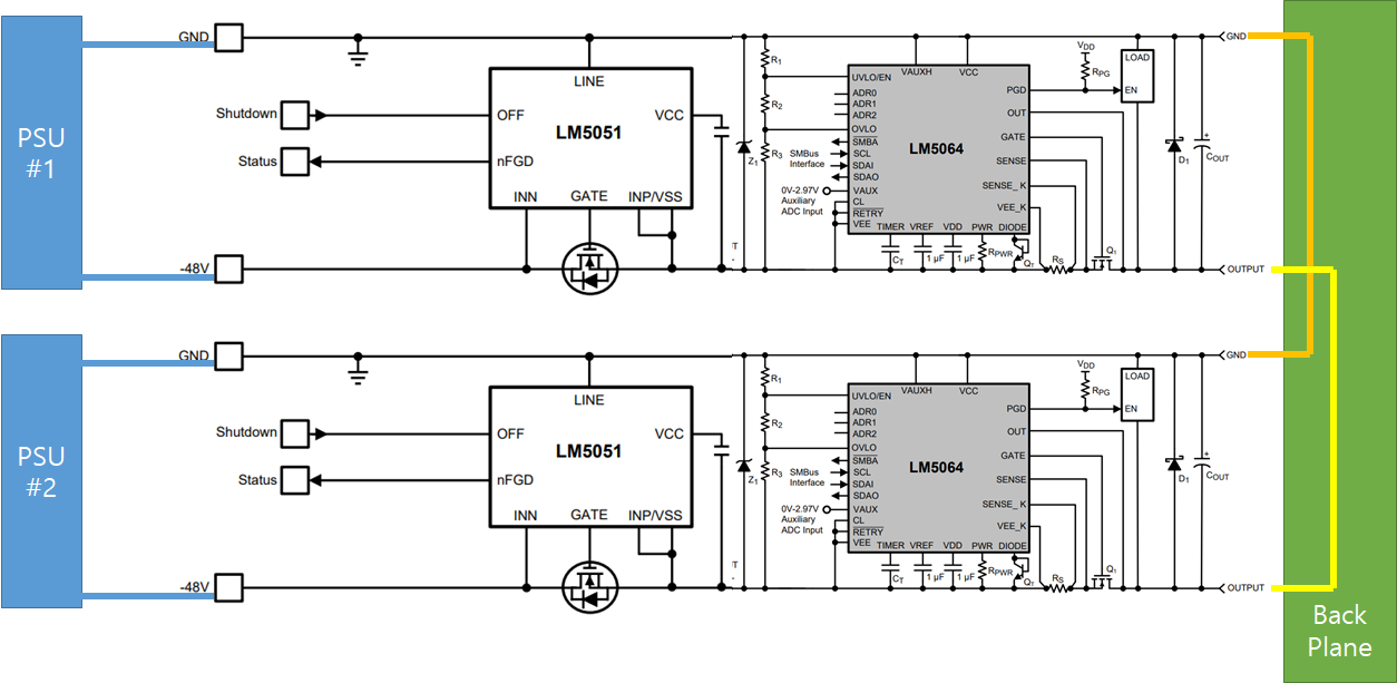

LM5064: Diode placement questions when configuring the LM5064 product circuit
Part Number: LM5064
Other Parts Discussed in Thread: TPS23525, LM5051
LM5064 product circuit configuration questions

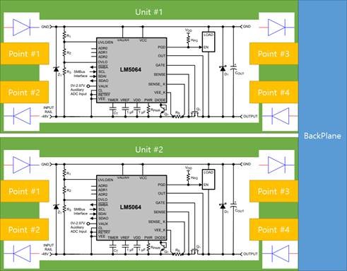

As shown in the figure, we try to supply power in the direction of BackPlane by receiving -48V input from Unit 1/2.
When Unit 1,2 is connected in the backplane, inquire about where to place the diode to prevent reverse voltage due to voltage difference, and whether there is a configuration to recommand
