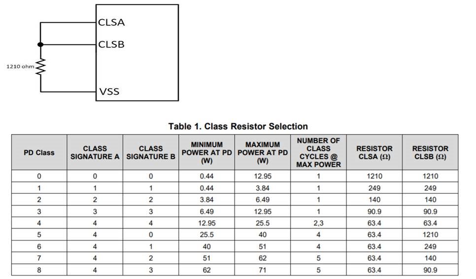

Hi team,
In the application of only setting the PD classification between 0 ~ 4, as the resistor value will be the same between CLSA and CLSB, could we combine the 2 resistor into one as shown below (class 0 with 1210 ohms, class 4 with 63.4 ohms)?

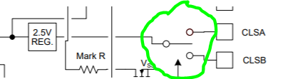

  • Hello SK Loo,
    Yes that is acceptable to do for Class 0-4. If you look at the Class A and Class B pins in the block diagram, you will see that only one connects at a time.
