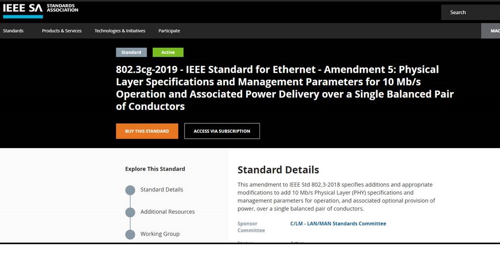

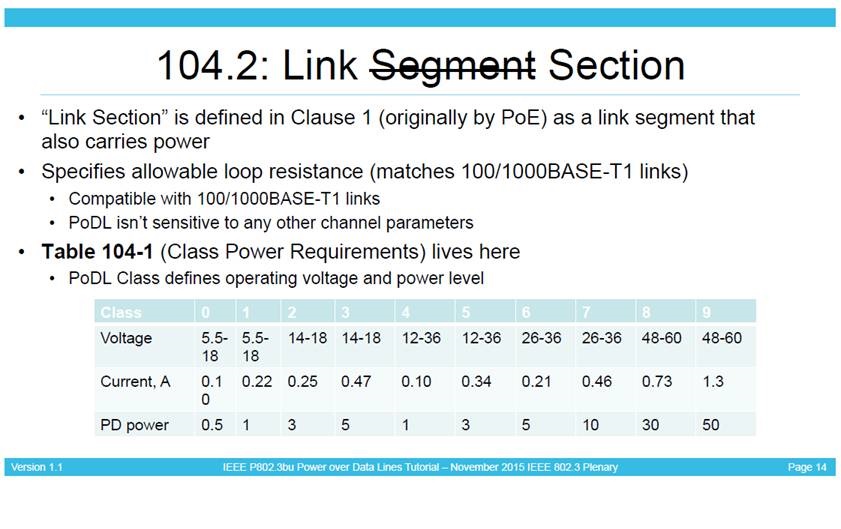

Hi Team,
Does TI have POE power supply only through 2-wire PD solution?
need the PD solution at the receiver end.
EX: solution propose by PODL or IEEE802.3 Clause 104.

Thank you for your question.
From PoE side, we do not have PoDL solutions today.
However, we do have PoE PD and PSE solutions for IEEE 802.3af/at/bt standards today.
