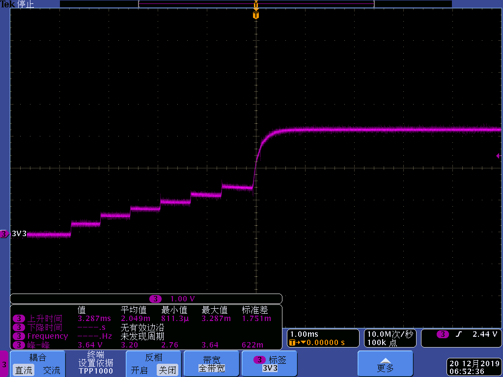

I knew,during startup, tps56221 may trigger the current limit. But in one of my customer desgin with no load startup test, there are many steps in the power up waveform.  I tried to increase the inductance and soft start time, no improvement. I also reduce the output capacitance.
Is there any other measure I could have a try?
I attach the schematic here.
3v3.pdf
Thanks.
  • When you increased your soft start time, what value of C579 did you use?
    Can you get a scope plot of output voltage, the soft start voltage and input voltage on same screen
    The 1000pF capacitor for C579 only gives a 60 microsecond soft start time.  Use a 0.1uF on EN/SS pin
