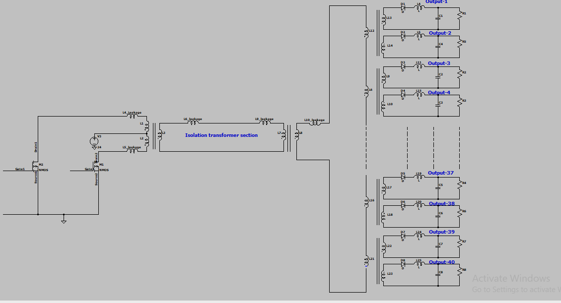

Customer of mine is considering UC2827-2 for new design and mentioned our requirements below,
Diagrammatic representation of circuit is also attached,
Required specification :
Topology : Push -pull voltage fed
Input voltage :24V
Isolation Bw source and load :20kV
No of outputs :40 Nos
Output voltage :20V
Output power on each output : 1.5W (Total power l:60W)
Output ripple :200mV
Efficiency :70 to 80%
I believe,  leakage inductance and primary current will be considerably high for the above requirements.
In order to achieve the required specification, I need to take extra effort while selecting snubber type and value of the passive components.
So can you pls help me to select suitable  snubber circuit for the above specification?
