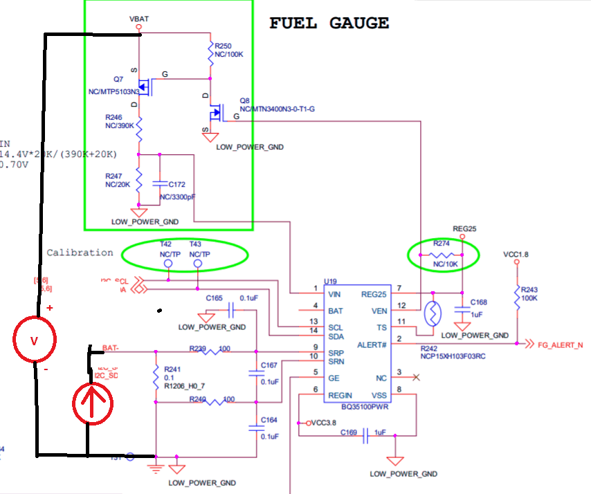

I was trying to do current calibration with 1000mA through bqstudio and making golden image.
But after calibration process, gauge reported current was not changed and still showed 1020mA as usual.

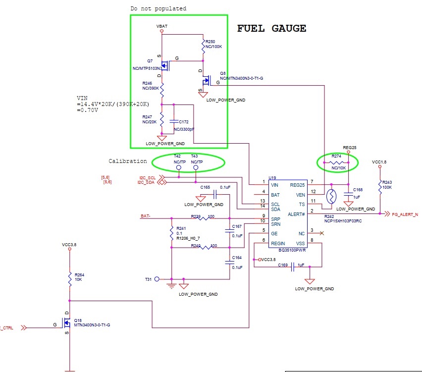

Gauge firmware is default. Schematic is attached and please note that components related to voltage reading are removed.
Please help to look into this. Thanks.
-Jimi

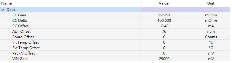

  • Jimi,
    Prior to sending the Reset command please read the datamemory and see if the CC Gain and Capacity gain values changed at all
    Eric Vos
  • Hi Eric,
    Prior to sending Reset command, still no values change in Data section at all.
    -Jimi

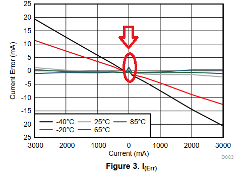

    After taking an average from 30 units and using that to program the rest of the units, the production units have <2% error with system current 100mA but about 1x% error with 10mA. Below are my questions.
    1. How much current accuracy would you expect when using this method of calibration?
    2. As you know we only write fix CC Gain/Delta that obtained from 1000mA loading calibration.
    With this method, if 10mA accuracy would be affected by CC Gain/Delta modification?
    3. Below figure I(err) from datasheet shows reported current has few mA errors in low current. If this data is from gauge default parameters or after normal calibration process?
    -Jimi
  • Hello Jimi,
    The current accuracy is based on the ADC range for SRP and SRN, also the temperature coefficient and size of the sense resistor. Was the error resolved with your system?
    I believe the error measurements are after the calibration, but I can check and get back to you.
    Sincerely,
    Wyatt Keller
  • Hi Wyatt,
    Thanks for your reply. To better check current reading accuracy, we'll set up as below to isolate system current  from gauge current sense and provide independent current source for current sense.
    Do you think this setup is valid to verify current reading accuracy?
    And we noticed EOS Gauge Load Current to compensate current reading. Would you suggest how we can use it with current accuracy checking as above?
    -Jimi
  • Hello Jimi,
    If the gauge is not using current from the same current source that you are doing the calibration, you will need to take EOS Gauge Load Current into consideration, it would be best to set it to 1 or add it back to your measurement.
    This setup should be okay to calibrate and test the accuracy.
    Sincerely,
    Wyatt Keller
