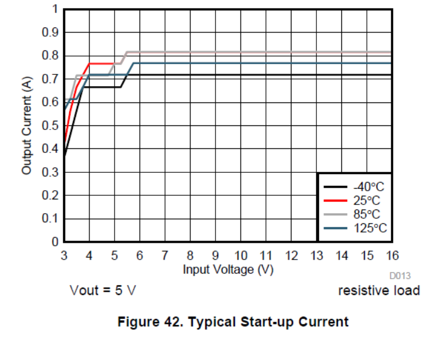

i have desgined a Power Supply with the IC TPS63071 (Fixed 5V Version) it works well so far, exept one topic:
when I apply the supply voltage to the TPS63071 device and there is an ohmic load of less than 7Ohm at the output, the output voltage no longer reaches 5V.
If I switch the load off and on again, the output voltage is back at 5V as expected.
Thomas
