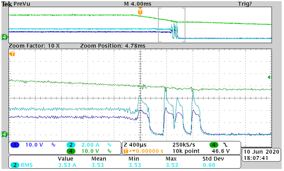

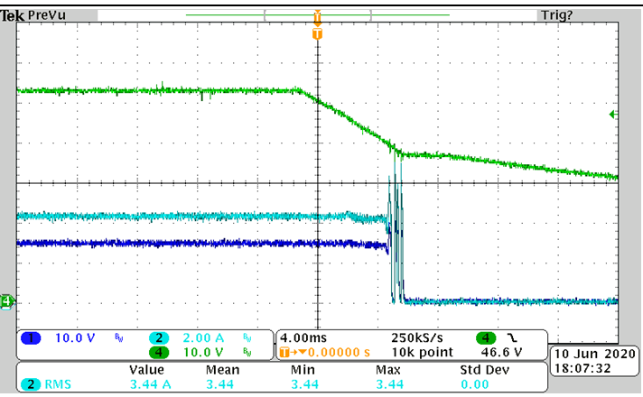

hi Sir.,
My customer found an issue at power off. At power off, there is noise close to UVLO voltage.
Zoom in.
CH1: Vout (10V/DIV)
CH2: Iout (2A/DIV)
CH4: Vin (10V/DIV)
If they use higher UVLO hysteresis range, the issue is gone.
can I know why it happens? something wrong in design?
