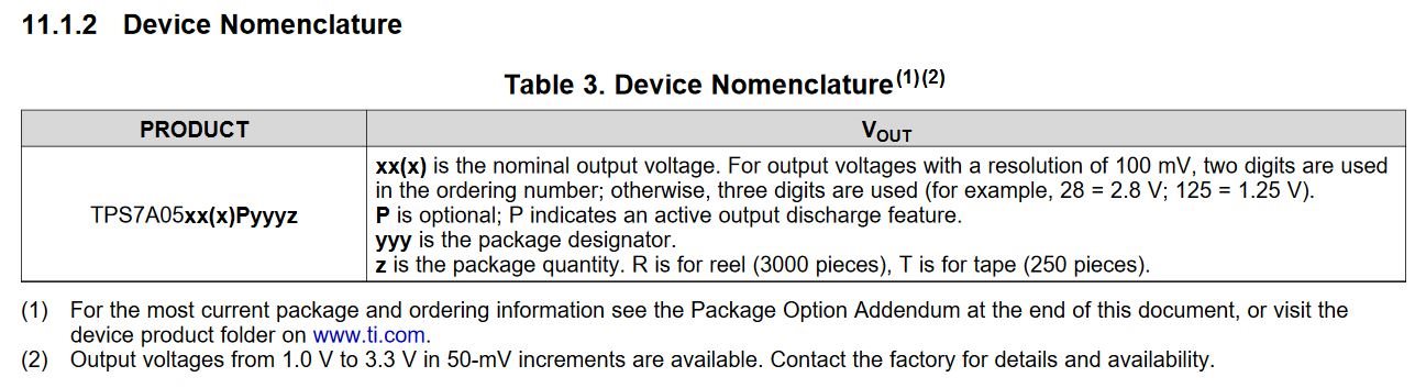

Hi
I seem not to be able to find how you specify the Vout in the part number from the possibilities (0.8, 1, 1.2, 1.5, 1.8, 1.825, 2, 2.2, 2.5, 2.7, 2.8, 2.85, 3, 3.1, 3.3)
