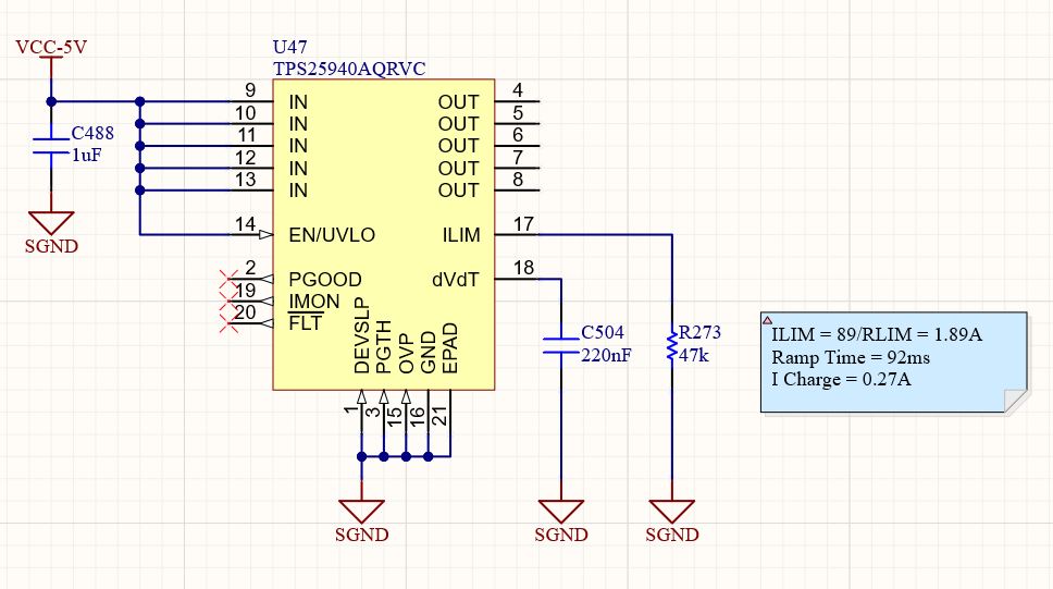

I am using the TPS25940A to charge a 5F super capacitor in a RTC backup scenario. I am having difficulty working out the set charge current for the capacitor (I would like less than 0.5A).
Using the TI excel spreadsheet tool for this device, it results in the following circuit.
CdVdT of 220nF for 92ms ramp time and Icharge or 0.27A
ILIM set at 1.89 with a RLIM of 47k.
Am I right in that the ILIM is the surge limit, but the 0.27A is the steady state charge current?
Is my circuit correct? (Still to add the super capacitor to the output.)
