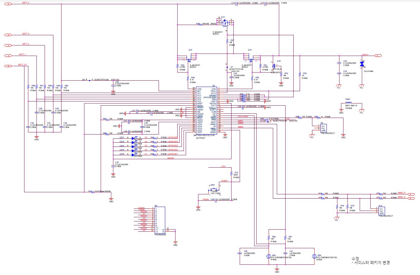

 I am using BQ20Z655 as a Removable battery Mode.
But CHG and DSG FET are not turned on when the battery pack is Reinsert
How do I do for operate FET when the battery pack is Reinsert?
I attached Design File.
Best Regards.

  • Hi Wyatt
    I answer the your feedback.
    You will need to make sure your gauge is configured correctly so that it is in a condition to turn the FETs on when a charge or discharge is needed.
    You asked us to make sure our gauge should be configured correctly.
               Unfortunately, now we are use the device BQ20Z655 first for this time. So we don’t know well which configuration of the gauge you mean.
              If the gauge configuration you said is the hardware schematic, we already referred the reference schematic the TI gave.
              As you can see the schematic you delivered, our schematic is quite similar to the reference one.
              Could you review our schematic if you find something wrong in it?
              Or if the gauge configuration you said means software part, could you explain more detail about that?

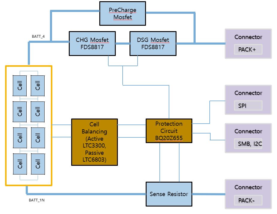

  • Hi Wyatt
    I attached block diagram of system.
    could you provide the recommendation .gg file?
    Best regards
